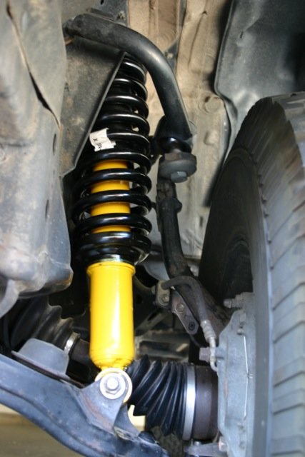

    Got the new OMEs on the front. Gonna test drive it in a bit to how the new valving feels.
