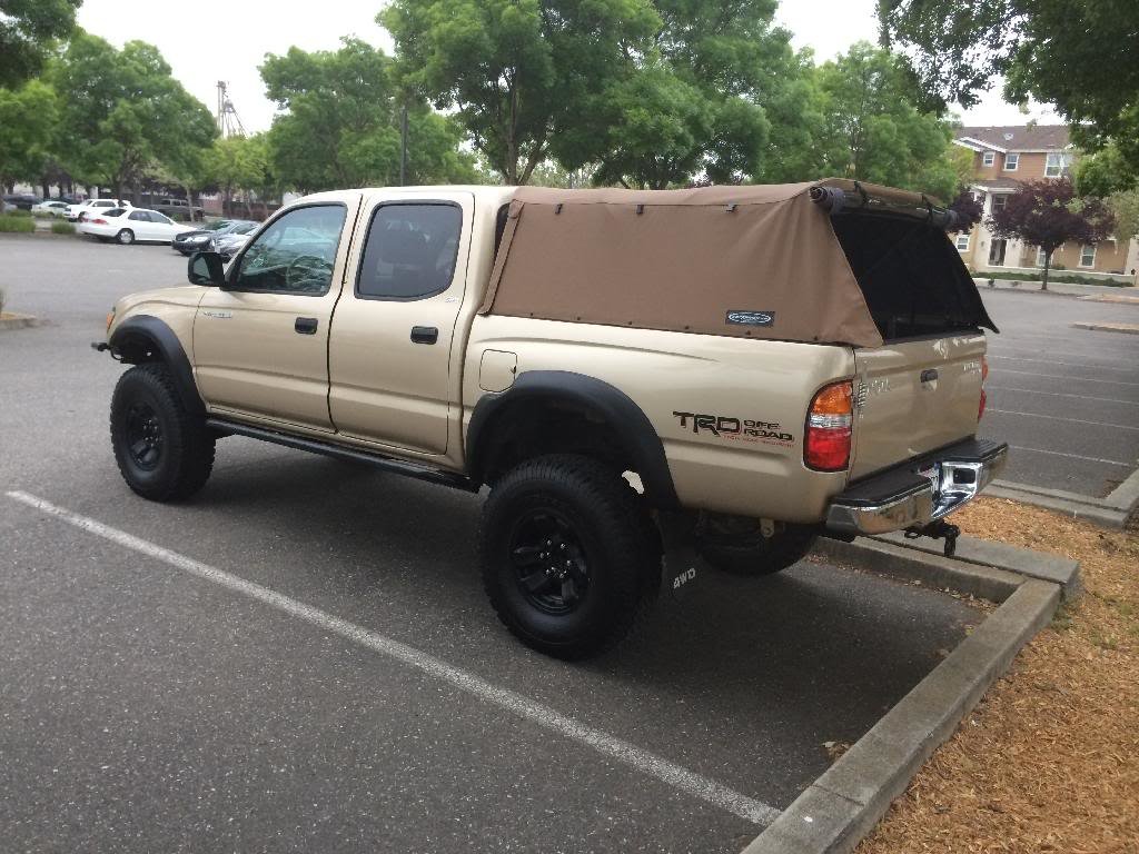

    I'm going to whore out my rig here again since I changed some stuff... Here is with 882, nitrochargers all 4 corners, Dakar pack, now with d6xl AAL, and shackles reduced to 1" lift instead of 1.5"

    Probably gonna be a week, aren't they on the west coast? You'll have fun with the install. Hopefully you take better measurements and before/after photos than I did...

    Trucks looking good! What size tires currently? Plan to go bigger? Tracking says it should be April 22nd. :) I wish it was next week already haha

    dat topper.... Nice rig! Whore on my friend

    33x10.5, might go to a wider tire when ready for a regear, but that is far out!
    Too bad they don't have time travel! Soon enough man, stoked for you.
