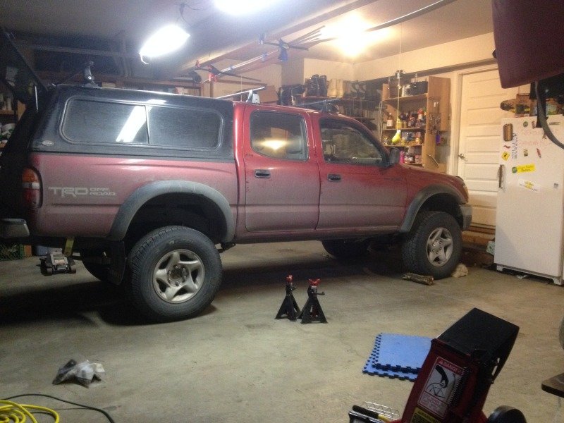

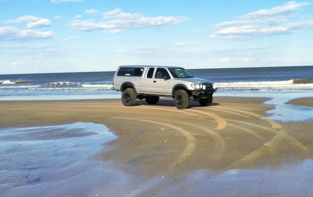

    Matic, the Expos are truly a weight spring the way they come from All-Pro. I had them on the back of my Extra cab and they were like 4+ inches including a spare tire, armor, and fiberglass cap. I am on 881s in this photo.
    I traded them to my brother who took out two leaves and he liked them. He is on 882s in this photo with extended shackles in the rear.
    He was carrying a shitload of weight there.
    Brandon
