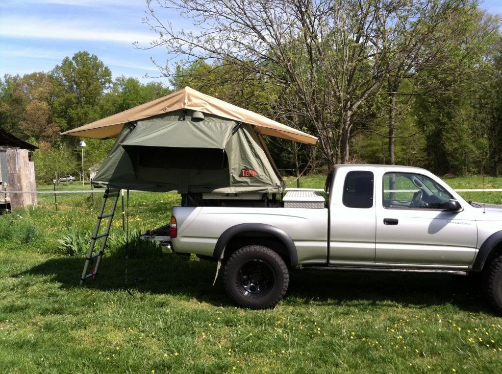

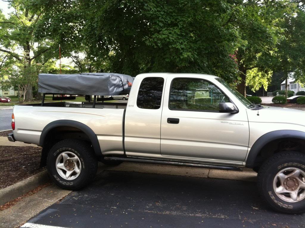

    ffirg, did you shim the axle at all? This a lot of driveline angle otherwise. My RTT really doesn't settle my trucks rear much at all with just the Dakars. Don't expect too much with the extra leaf installed.
    My RTT setup weighs about the same as just my fiberglass cap did, maybe less.

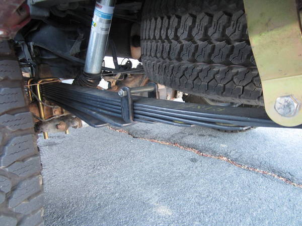

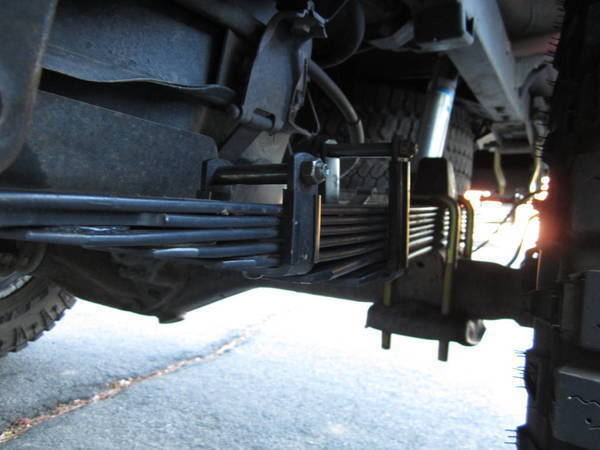

    Question for those running OME rear leafs.... Has anyone changed out the front bushing that comes molded into the eyelet ?
    I want to install a poly bushing there before I install my leafs, but I'm wondering if that eyelet will accept a poly bushing.

    I was wondering this a little while ago also, that bonded rubber bushing tends to seize up in the eye after long use.

    I used the bushing that were pressed into the main eyes. Actually if you look back a bit through this thread you will see that I recently replaced them. I used the pressed in Toyota Bushings again. There is a little noise but hardly noticeable.
    You could easily swap them out for polys if you wanted, just need a press since those other bushings are sleeved. If you don't have a press you can burn out the rubber and use a sawzall to cut the sleeve.

    my .02.... you guys are over thinking it. antisieze it if you are worried about it.... the rubber does just fine. when its worn, replace it.

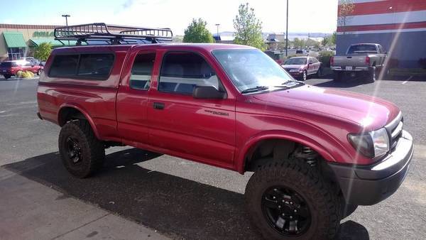

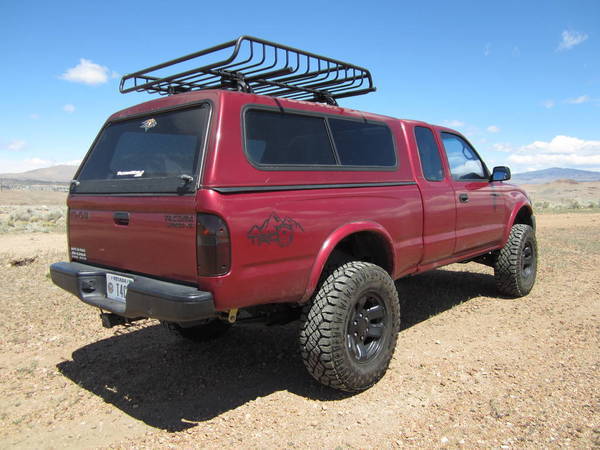

    Got my Dakars on today!!!

    looks good! maybe trim those bolts eventually

    That looks great.

    Thanks! Yup, didn't have time today but gonna make sure I leave room for AAL and do it soon.

    Thanks man, happy to finally get that done, had the heavy bro lean for about 2 weeks.
