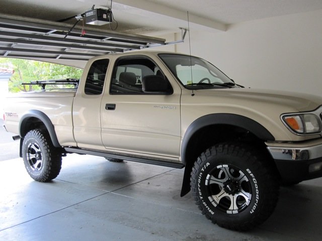

    I'll see if I can find a picture pre-bumper.

    Best shot I got right now. Not the greatest.
