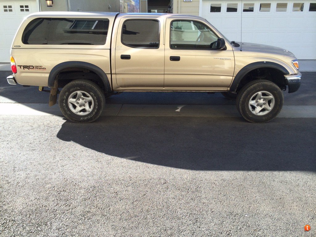

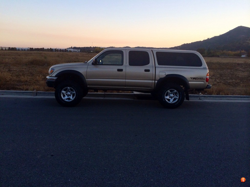

    To give you an idea, the Dakar pack (2.25" advertised lift) I put in my truck with 882 no aal:
    See the lean? Here is same setup with 1.5" lift shackle:
    Pretty much level, I think about 1/4" rake.
