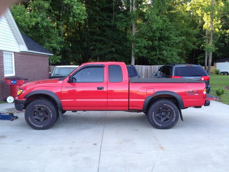

    Finally installed :D did not add the extra leaf. Left it off for now.

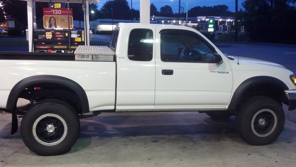

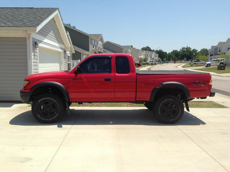

    Finally all done! OME kit from wheelers with 881 coils, 10mm top plate spacer,LR UCA, driver side trip packer, nitrocharger sports, dakar leaf pack with greasable shackles. Truck is dirty but at least its lifted, the cleaning mod will come next. Before and after pictures!

    Looks good tacomamaineiac
