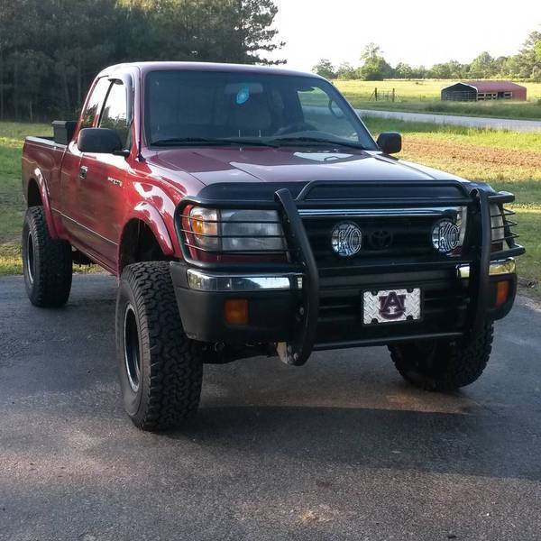

    1998 Ext Cab 3.4 4x4 TRD 5MT, 2004 DC 3.4 4x4 TRD
    Perfect stance IMO
    Are those 265/75 r16s?
