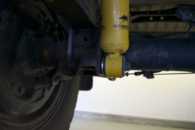

    Added a washer on the passenger side in an attempt to keep the leaf pack from rubbing the shock. Hope it works.

  12. May 24, 2014 at 7:39 PM

    5,371
    The Desert SW
    2012 FJ
    Not sure I understand. The stock washers are on there already.
  13. May 24, 2014 at 7:42 PM
    #1133
    Scenekyd
    Scenekyd Not much of a member
    Nov 15, 2013
    #116629
    3,624
    Jay
    Hendersonville, NC
    2015 Ford F-250, 2016 4runner Trail
    I see em now, sorry, on my phone so can't really see. My leafs don't rub my shocks though with stock washers
  14. May 24, 2014 at 7:50 PM
    #1134
    tomtom
    tomtom Well-Known Member
    Jul 15, 2012
    #82706
    5,371
    The Desert SW
    2012 FJ
    yeah, not sure why mine do. The previous set of regular nitrochargers got a nasty dent in 'em because of the leafs. Some time, I'll be doing a relocation but probably after I learn how to weld.

    Is this common with OME?
    I don't understand how they could design it in such a way that the leafs rub the shocks.

    Ask Adam (BoxRocket) for a second opinion. I've heard that it is a problem. The previously mounted regular nitrocharger got a good dent put in it from the leaf pack. The new one, a nitrocharger sport, has some slight rubbing on the sticker. The paint has not been broken and no dents so far. Figured I'd be a bit proactive, just in case.

    I used a 3/4" flat washer I picked up at Lowe's for a $1.18.

    Why not just flip them? Run them shaft down. They are nitrogen charged aren't they?

    In the old days of emulsion type shocks, the body had to be run in the down position. Not sure if those OME shocks are the emulsion type but would be very surprised if they were. Almost all shocks are twin tubed now and charged with nitrogen which means they can be run with the shaft down so this becomes a non-issue.
