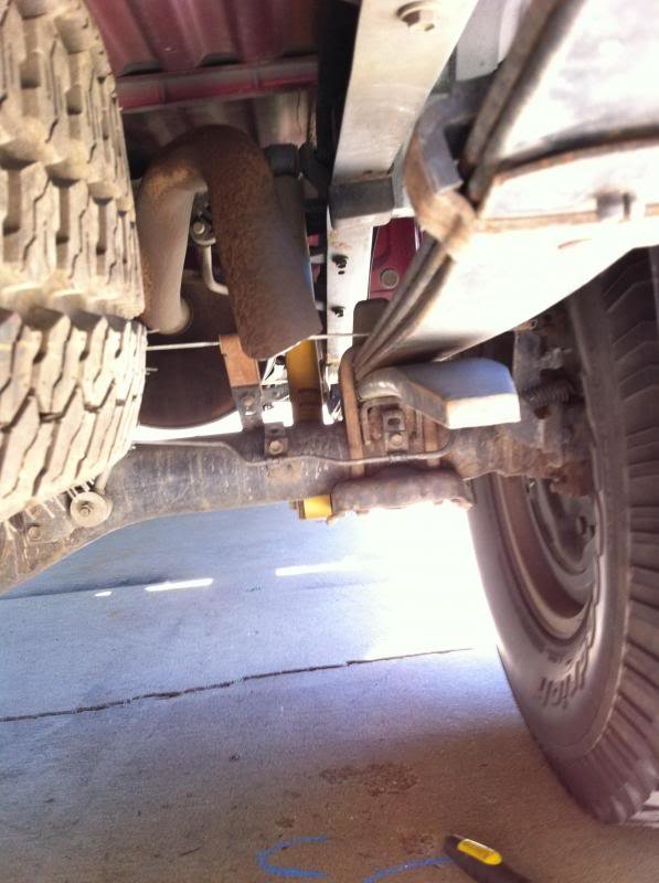

    Here is some other pics along with some questions. This is the exhaust relocation bracket. From what I can tell all it does is push down the end of the exhaust.
    After I installed the bracket it still seems to be rubbing on the leaf pack. Is that normal?
    Has anyone changed out the muffler hangers to help with this? They seem to be holding the exhaust up.

    My solution- I cut off about 2 feet of the pipe :eek:
    Edit: BPV looks correct!
    :thumbsup: truck looks good man

    You can just cut the exhaust right after the axle. A lot of us did.

    If you want the expensive solution, can get the Magnaflow catback kit. It re-routes between the pack and the frame.
    http://www.tacomaworld.com/forum/1st-gen-builds/259729-tomtoms-03-trd-xtra-cab.html#post6330159
