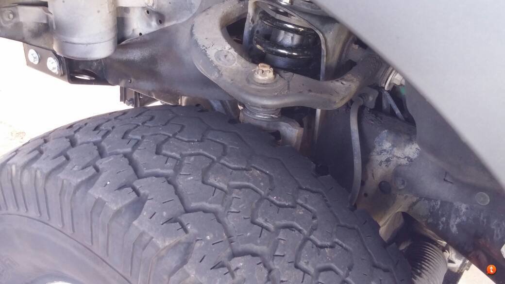

    So I ran into a pretty big problem today. I tried mounting my new tires 33x10.5x15's with stock rims and found out that the front tires hit the upper control arm.

    cheap solution is wheel spacers. The expensive solution is aftermarket UCAs.

    Weird, I have same tires and no biggy. U get an alignment? I did install wheel spacers though for more breathing room.

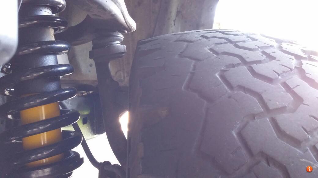

    This is what it looks like with the 31x10.5R15's. I don't know if you can tell but the top of the tire sits right under the UCA
    The 33x10.5x15's are slightly "wider/bulgier" and when the truck was lifted for swapping tires they sat tucked underneath the UCA's. When I tried to lower the truck the UCA's rested on top of the tires.

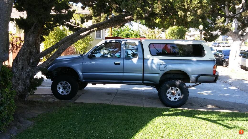

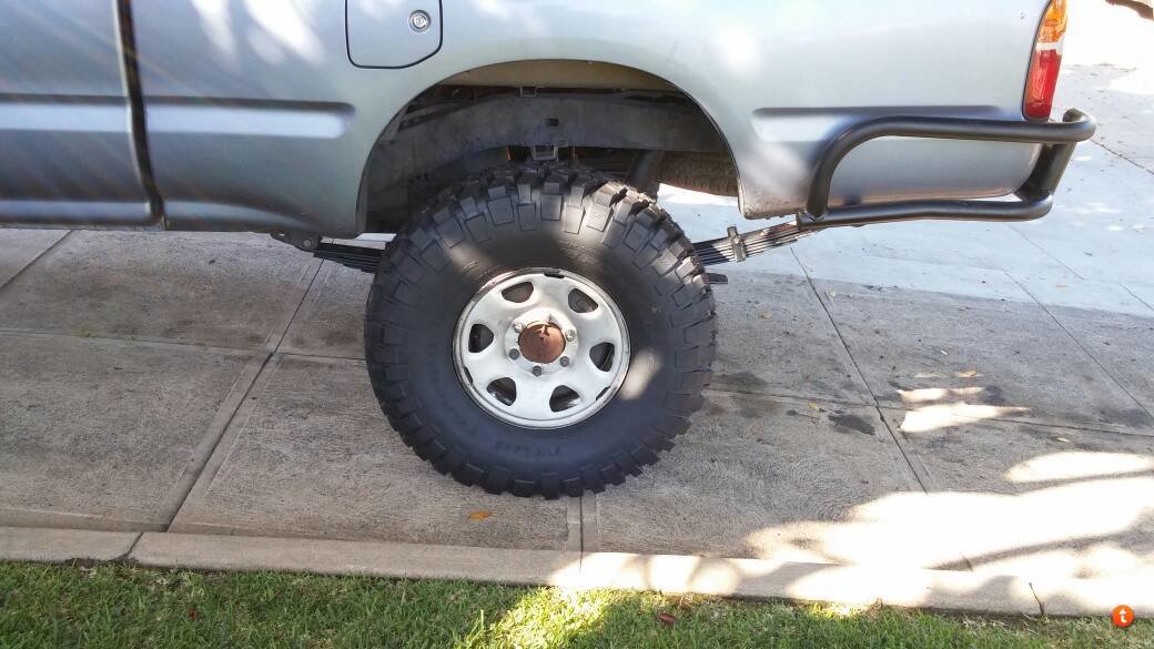

    Here's what my truck looks like now tubamyry_6b27b3b5054f62d6c4648da5a6209d16cc5c4b37.jpg
    The new tires on the back and the old ones up front. I was thinking of getting spacers, but a buddy of mine is going to try and get me some wheels with a different offset to see of that solves the problem.
    Also the rear wheels seem to be off center 7y5u8e9a_6a09621307c7a6d40994d93ae774c8ca825921c6.jpg
    I think there's a shim I can get to correct this.

    Yeah man, looks good! There is a shim to address the off center wheel but tbh I haven't found it to be an issue on mine, and mine are as bad or worse - I do stuff the rear pretty hard from time to time.

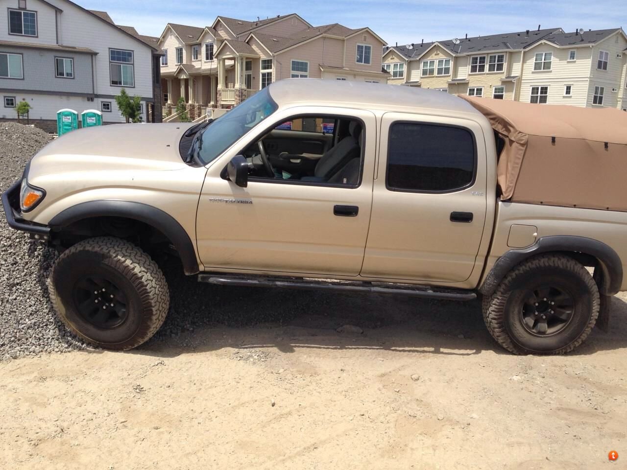

    Here is a flex pic before going wheeling:
    Also as to the wheels... Might be your problem. I think factory is 4.5ish. I have a set of used 4r 15" picked up for $100.00, might want to look into that or aftermarket. Not sure what your wheels are, so take the above with a grain of salt ^

    Yeah the wheel backspace is probably why your hitting the UCA. Some spacers or aftermarket wheels should fix that. I have 4" BS wheels and they have plenty of room.
    The reason the 31" tire looks so close to the UCA is because the lift drops the angle of the UCA and now it's angled downward toward the tire more than when the suspension was stock.
    The less backspace or wheel spacers will push the tire out enough to clear the UCA
