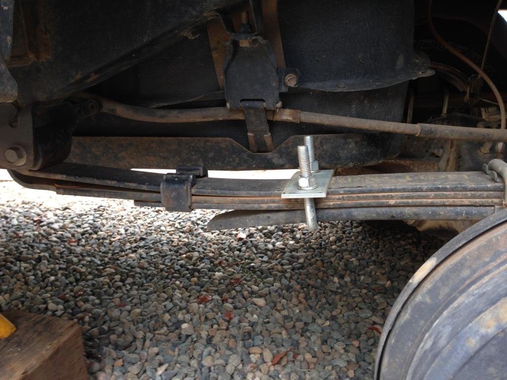

  3. Jul 24, 2014 at 3:50 PM
    #1263
    TacoREX
    TacoREX -TacoREX
    May 17, 2014
    #130048
    219
    Evan
    NORCAL
    01 Taco 2.7 5spd
    2.5" lift, 285's, CB, DIY HiLift Bed Mount, AllPro Sliders,Warn
    Friend gave me his old spacers and in the process of install found that the ghetto axle wrap mod was making the old tired leaf packs much worse. Ordered up the Dakars and waiting for them to arrive. Also ordered 3 degree shims and bushings from Wheelers. Currently I'm sitting on stock springs coils with the bilstein 5125 and 5100's, I'm level with 2.5" over stock. I ordered the shims just in case, as the blocks I have are shimmed and I'm not experiencing any driveline vibs. Anyone else using them? Also anyone know of any homemade or purchasable kits to flip the ubolts?
    0815CD5C-CED5-41B4-96B7-6A69B8778515_zps_f00e6844ad774b71d0721948dd0284cdc17494e2.jpg
  4. Jul 24, 2014 at 10:00 PM
    #1264
    Digiratus
    Digiratus Adventurer
    Mar 26, 2010
    #34006
    23,830
    Roaming the PNW
    The RedHead
    2002 XtraCab TRD 4x4 SCv6 AutoTrans With Lots of Mods ADS COs w/Compression Adjusters Camburg Uniball UCAs Whiteline Lower Control Arm Bushings Kartek 7" Limit Straps Plastics Guy Front Bumpstops Total Chaos Sprindle Gussets Custom Alcan Springs +800 lbs +3" ADS 10" Stroke Triple Bypass w/Resi Rear Shocks Custom Rear Shock Relocate All-Pro U-bolt Flip w/Timbren Bumpstops 4.88 Nitro Gears ARB Front Locker ARB Twin Compressor Black 17x8 Konig Countersteer Type X 285/70r17 Falken A/T3w Gunmetal 16x8 SCS Ray10s 255/85r16 Maxxis Bighorns Limited Edition (Relentless) Elite Front Bumper Smittybilt X2O 10K Winch Diode Dynamics SS3 Sport Selective Yellow Fog Lights in the Bumper Diode Dynamics SS3 Pro 4,000 Kelvin SAE Driving Lights with Clear Lenses on the Bumper Morimoto D2S Projectors XB35 Ballasts + 4300K Bulbs Badland Sliders FrankenFab Tire Carrier Swingout bumper w/kitchen BudBuilt Front & Bellypan Skids BAMF Rear Diff Skid Dometic CFX 55im Fridge/Freezer Alpha II Hardshell RTT Badland Custom Bed Rack Denso 210-0461 105 amp alternator Dual Northstar 24F AGM batteries BlueSea 7622 ML-ACR Battery controller Peak DBI Dual Battery Voltage Monitor Haltech IC-7 Display with Mako Dash Insert Haltech Elite 2500 Standalone ECU Magnuson MP62 Supercharger w/URD 2.2" Pulley Doug Thorley Headers Denso 650cc Fuel Injectors Aeromotive Stealth 340 Fuel Pump TransGo A340F Reprogramming Shift Kit OEM ECU Delete Full A340F Trans Control with the Haltech 2500 ECU 2.5" Magnaflow Hi-Flow CAT Magnaflow 18" Muffler w/Vibrant Resonator 13WL Brake Calipers with OEM Rotors & Pads Braided Steel Brake Lines Kenwood TM-71A Dual Band Ham Radio STI-CO Flex Whip VFH/UHF 1/4 Wave Antenna Midland MTX275 GMRS Radio w/Roof Mount Antenna Pioneer DEH-P9400BH HU Alpine Amps & Type R components (F) and coaxials (R) Wet Okole Seat Covers Weathertech Digital Liners Deck Plate Mod 1" Diff Drop Carrier Bearing Drop
    This is the Trailgear kit that I used.
    http://www.lowrangeoffroad.com/u-bolt-flip-kit.html

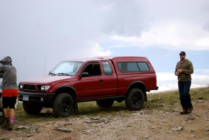

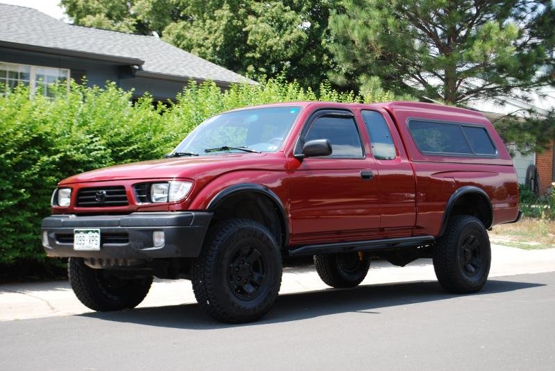

  18. Aug 12, 2014 at 6:09 PM
    #1278
    Monkeysuncle
    Monkeysuncle My Cat's breath Smells like Cat Food
    Aug 27, 2008
    #8809
    1,247
    Kevin
    Florida
    99 Tacoma SR5 4x4 5 speed Manual Hubs
    Diff Breather,CB thingy,GPS,Cop Shocks,Cop Brakes, old Man Emu 881's Dakar Leaf Springs and Nitro sport shocks. Deck Plate mod
    So not quite 4 months later....
    My front inner factory boots did leak somewhat. They no longer leak.
    The outer boots did rub, I didn't have the money or time to do anything about it. I let it go knowing this is 1 of 4 vehicles we have to drive so when the boots split then I would address it. The boots no longer rub. I would think the springs found their happy place. Just enough time to settle in.
    The rear Dakars did make a bit of noise, but almost 4 months into this they are quiet as a church mouse. I keep out of the mud. I wash the trucks under belly each and every time it gets dirty. No salted highways in Florida.
    4x4 once every weekend going to fishing hole. I drive mainly around town.
    My mother-in-law has worked the rear springs over with her trips to home depot more than I have fishing.
    Like I said, this purchase was to refresh the old worn out factory set up.
    I love it.

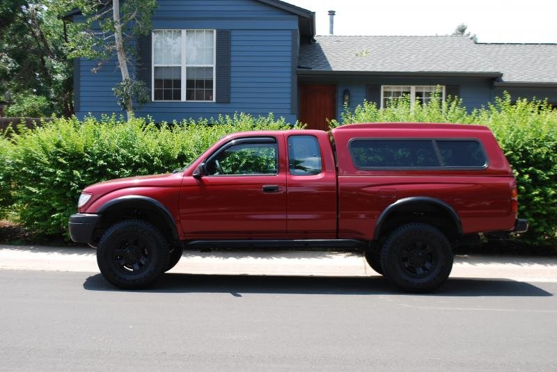

  19. Aug 12, 2014 at 6:22 PM
    #1279
    Monkeysuncle
    Aug 27, 2008
    #8809
    1,247
    Kevin
    Florida
    One more thing, the orange yard stick in the picture doesn't touch the top of my wheel arch to this day. Still over 1.5 inches space.
    I also helped a buddy out picking up an appliance from Lowe's. He has a factory 2002 4runner. He told me to avoid a big dip in the road on the way to his house.
    I hit full speed. He really liked the way the truck took the hit, asked me about OME.
    Hamer95USA likes this.

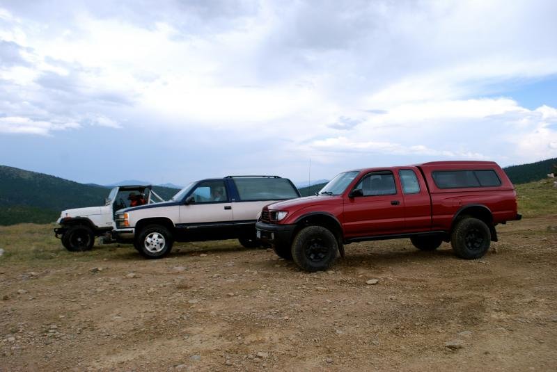

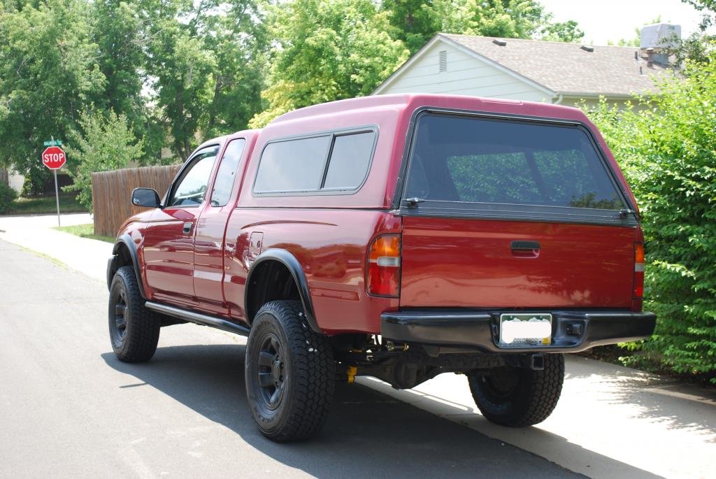

  20. Aug 12, 2014 at 7:09 PM
    #1280
    Madjik_Man
    Madjik_Man The Rembrandt of Rattle Can
    Dec 2, 2009
    #26893
    19,742
    Colorado Front Range
    1998 Ext Cab 3.4 4x4 TRD 5MT, 2004 DC 3.4 4x4 TRD
    1998 V6 5-speed TRD 4x4
    31x10.5 r15
    881s
    Dakar leafs
    Nitrosports all around
    ee8fe176-0005-43ff-8313-08fb92f7f68b_zps_1c3879fedec531a4572837cc0465356620c88a05.jpg
