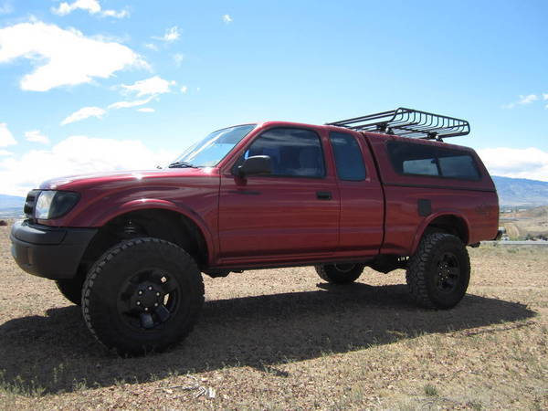

    Dakars are my only OME part but I thought my truck has a striking resemblance to ^^^^^^^^
