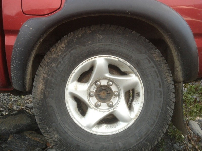

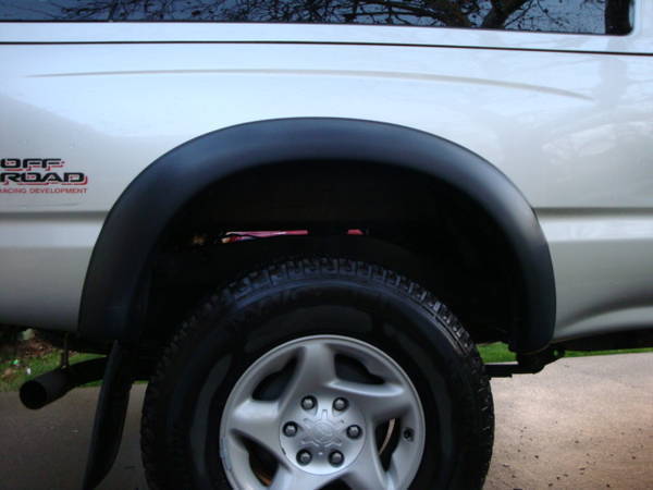

    Looking for a hasty answer on this, as I only have 3 more weeks before bugging out on a 10-day trip to Utah.
    I've combed this thread (and some in TTORA or elsewhere) and seen everything from no problem to shifted forward about an inch. It also seems to not matter year (99-04) or type (prerunner, 4x4, Xtra cab, DC, whatever).
    Has anyone been able to determine what causes this at all?
    I'm about to ditch my Wheeler's 5-pack in favor of the Dakars now that I have a fulltime Snugtop, 50 lb rubber bed mat, added a hidden hitch, and am towing a small camper while the bed is full of gear.
    About to hit the buy button, and it would be nice if I knew I should get relocation plates just in case, and what the best source (with minimal addition lift) for these is...
    :notsure:
  5. Sep 3, 2014 at 11:27 PM
    #1325
    ffirg
    ffirg Well-Known Member
    Jun 9, 2011
    #57975
    4,876
    mike
    Anchorage, Alaska
    2002 Tacoma SR5 TRD 4X4
    I have not noticed a need for relocation plates. My tires sit perfectly centered between the wheel well. Maybe the ALL has something to do with it but I don't see how that'd be.
    This was the week I installed them and they still do the same.
    756DFB3B-96A1-4924-AD81-6B3CB8BDCF0D-304_60130842ecaf63a149f8cfcd5f4d3ea4c935edc2.jpg

    Mine most definitely needs relocation plates and they are sitting in the garage waiting to be installed. The front of the fender flairs/wheel well has got a good bit of wear from rubbing at full stuff.

    I wouldn't worry about it too much unless you plan on stuffing the hell out of your tires. Mine could move back about 3/4" but hasn't torn the flares off yet :) if you need to add on later, I don't think it is too difficult.

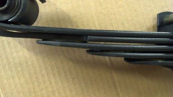

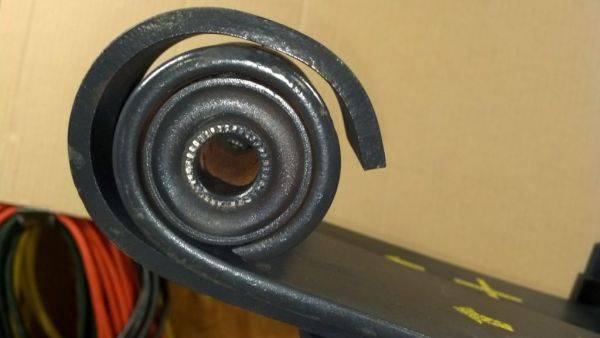

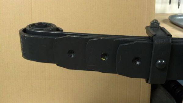

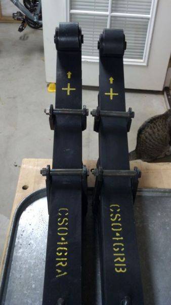

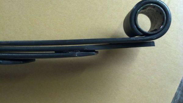

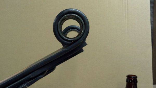

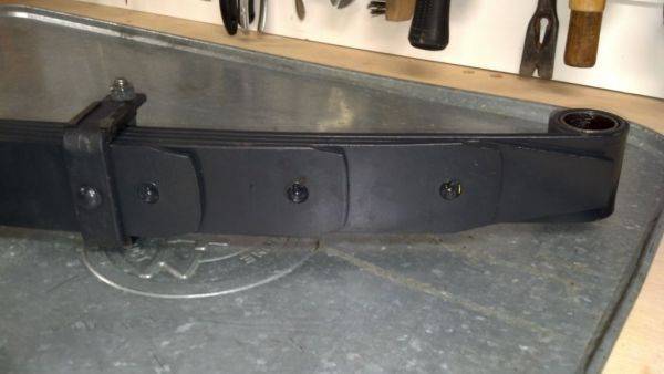

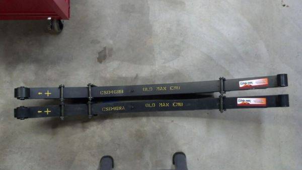

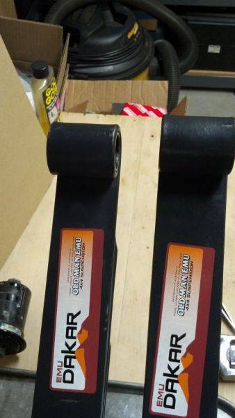

    I thought people might appreciate a set of detail pics of Dakars before install that show the difference in A and B sides, the preinstalled front hanger pin bushings, the antifriction pads (and interestingly, a couple spots between the top and second leaf where there is contact but no antifriction pads), the plastic anti-chafes on the leaf retaining clips, etc.
    Generally, all the vendor sites selling them show generic pics of the leafpacks that are not model-specific and often don't (possibly never) even show the double overload leafs that our trucks get.
    Difference in A (front) and B (rear) front hanger eyes height.
    Preinstalled front bushing and military wrap.
    Antichafe on leaf retaining clips
    Rear eye difference
    Another shot of A (left) and B (right) difference.
    And the rears, B (left) and A (right)
    Front antichafe pads; note the lack of pad between top and next leaf. Potential source of noise.
    Front, from bottom, indicating where the antichafe attachment points are
    Rear antichafe pads, and again lack between top and next
    And from bottom. ARB indicates that you can actually grease the pads from below through the hole in the center of the pucks.
