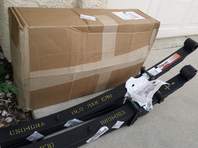

    shell, grey wire, turn signal relocate bumper ordered lift OME ordered
    Had this package deliverd yesterday :).
    Have to wait till nov 10 to install though
