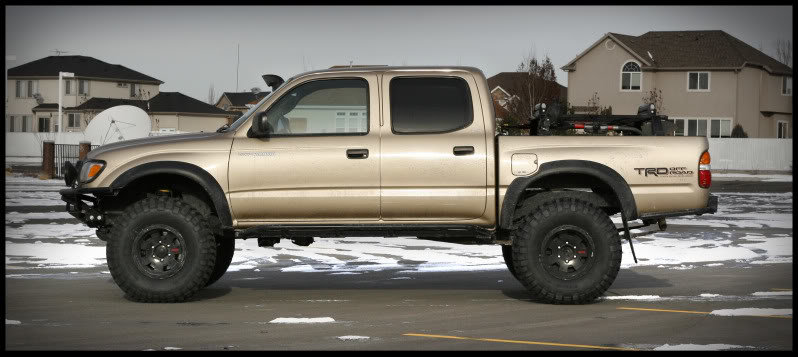

    Installed the D6XL AAL to my Dakars yesterday. Probably 1.5" of additional lift currently but that should settle a little. Load capacity should be much improved.
    before: dakar rears, AP 1.5" shackle. 882 fronts, 10mm trim packer.
    after: dakar rears, D6XL AAL, AP 1.5" shackle. 882 fronts, 10mm trim packer.

    truck looks great, I think adding the add a leaf looks good.
    I have close to the same set up as you do except for the Dakars and 882s, Iv got the wheelers 5-leaf springs with 1.5 in shackles and 881s with the 10mm spacers on top.
    I am thinking that my rear end might start sagging a little soon, it has already settles quite a bit since i installed everything. I also already do and am going to be adding a lot of weight to the back of my truck and I am thinking about getting the AALs to compensate for the weight and the occasional towing that I do. Does the AAL make your truck ride any rougher?

    It's a little more firm for sure, but in a good way. Not bad on the road, and I'm sure it will be better off-road especially when loaded.
