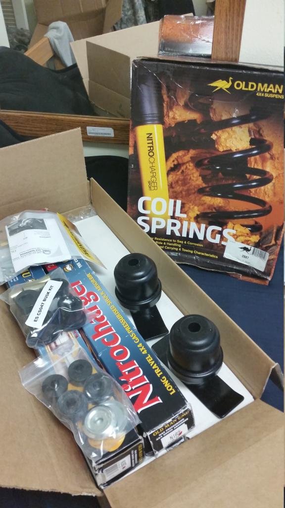

    What does the "Main eyebolt kit" include?
    Is the front spring hanger bolts for each side included? The reason I ask is I helped put a set of dakars on an "04" AC and both fron hanger bolts were seized in the sleeves. We had to cut the bolts on both sides of the spring which was a real pita. Replaced them with lowes grade 8 bolts/nuts.
  3. Nov 16, 2014 at 3:40 PM
    #1403
    JTrean
    JTrean Well-Known Member
    Nov 23, 2012
    #91705
    137
    It comes with new bolts, nuts and washers. Here's a link:

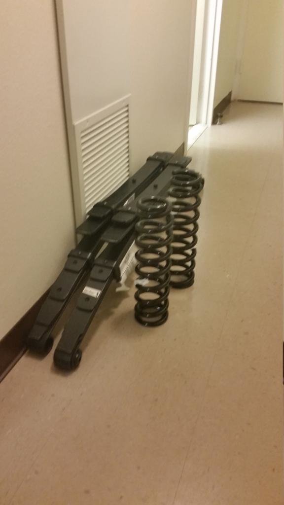

    anybody have good luck reusing the stock shackles?
  15. Dec 15, 2014 at 11:59 AM
    #1415
    Sloth
    Sloth Baby Ruth?
    Nov 16, 2012
    #91263
    12,567
    Seth
    Democratic Peoples Republik of Massachusetts
    07 FJ Cruiser, 98 Landcruiser
    Stuff
    Can't with the ome leafs iirc. You need to use the ones supplied.

    I just looked up the part for the bushings and they state they are only for use in OE shackles. My kit came from 4x4parts, it was a bit cheaper and didnt include greasable shackles. hopefully i can do without destroying them! IN which case i'll will be upgrading the shackles...hmmm

    I'm using stock shackles with OME leaves and bushings.

    I'm running the stock shackles but I recommend you plan on new bolts. Mine were bad and one needed to be cut off but the stock shackles work great.

    Any time you remove a big ol' bolt on a critical component, and it's been on for some time, just pop in a new one. It is the prudent thing to do.
