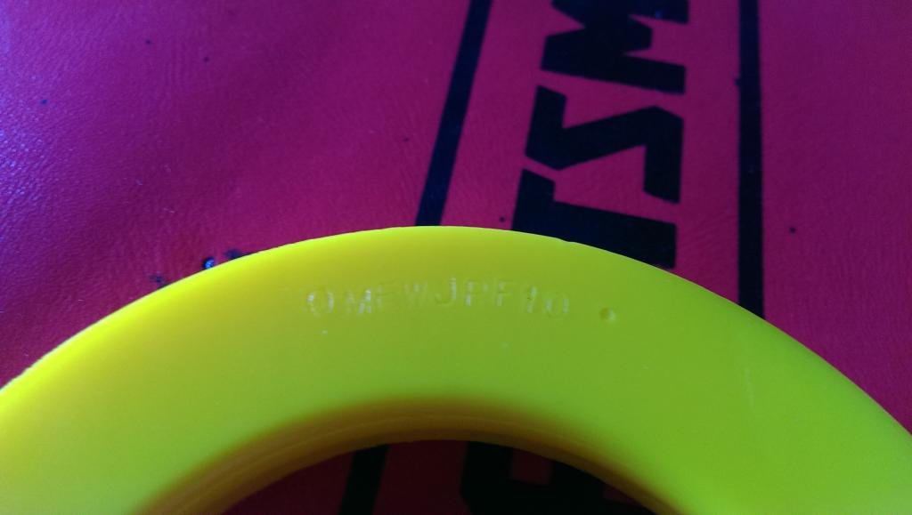

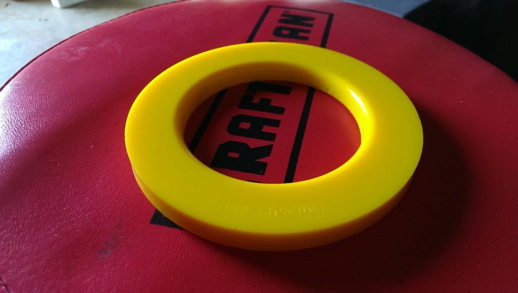

    This is the 10mm spacer I was sent. I might have screwed up but is this one I can use?
    Thanks
  7. Dec 21, 2014 at 9:32 AM
    #1447
    SnowroxKT
    SnowroxKT Well-Known Member
    Dec 11, 2011
    #68604
    5,319
    Kyle
    Anchorage Alaska
    2008 TRD OR
    Is that the in-coil spacer? or top plate spacer?

    In coil, I'm hoping it's the one boxrocket has...
    Looks like this
    I'd imagine it would work though..

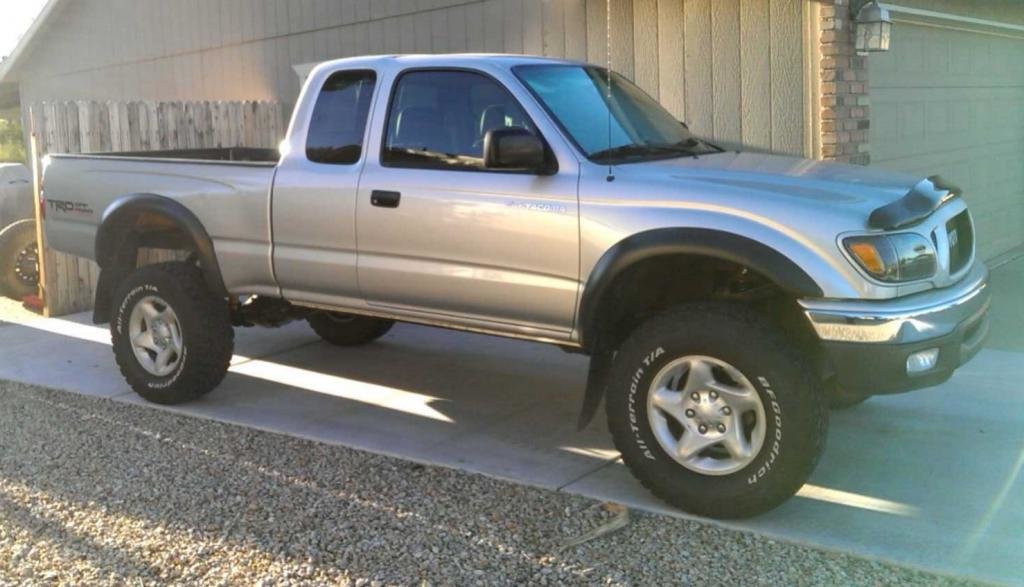

    I just picked up a 2001 regular cab this week and it is ugly right now. I am wanting to put on a OME lift but have questions with which coils (881, 882, or 883) to use. I would like to have my truck sit level with maybe slight rake. I do plan on adding an ARB bumper and my m8000 warn winch. This however will be several months down the road and I don't want to purchase another set of coils when I do purchase the bumper. I just retired my 94 Toyota pickup due to frame issues and swapped over my 33 10-50 KM2 to my new Tacoma. It is way to much tire currently and rubs pretty bad. After reading this entire thread I think I will go with wheelers complete kit. I know a lot of these questions have been answered but the majority of the trucks have a 3.4 and are double cabs. My question are
    *will the 883 be to much with 2.7 engine?
    *Will I run into any CV problems with the 883 on my truck
    *Will that complete kit clear 33's
    *Should I add anything additional to the kit?
    *Will the Dakar's in the back be enough or should I look at AAL too?
    Thanks for the help
  13. Dec 27, 2014 at 7:35 PM
    #1453
    Deathbysnusnu
    Deathbysnusnu Work is just a daily detour to happy hour.
    Oct 4, 2013
    #113825
    17,102
    Brett
    Fort Crawlins, CO
    Vintage Tundra
    Dog, camper.
    Welcome to TW :)
    Bear in mind there is really no way to say flat out what is best for your ride.
    CV angles vary by truck. You may or may not need the diff drop kit. I think it's a cheap and mildly effective way to help the angles out.
    I'd recommend an extended length rear brake line. Don't bother with the fronts unless they are bad.
    The AAL depends on what extra weight you will be carrying, I don't think the topper is heavy enough to sag the Dakars alone, and you can add longer shackles and preserve the ride if a little extra is wanted. Opinions vary on this one.
    In my personal opinion, I think 883's will be too stiff with a 4 cyl reg cab. Even with the ARB bumper and winch. I'd consider 882's. Same ride height with a softer ride.
    You can clear 33's without the lift, even with the lift you still have to do a little clearance on the front fenderwell pinch weld. You front wheel travel/range of motion does not really change with or without the lift. But it looks way cooler with the lift.:cool:
    T@codawg likes this.

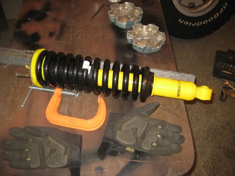

    -Old Man Emu 883 front coils
    -Old Man Emu Nitrocharger Sport front shocks
    -Old Man Emu Dakar rear leaf springs
    -Old Man Emu D6XL Add a leaf
    -Old Man Emu Nitrocharger Sport rear shocks
    -Old Man Emu greasable shackles.
    Relentless fab front and rear bumpers to follow.
