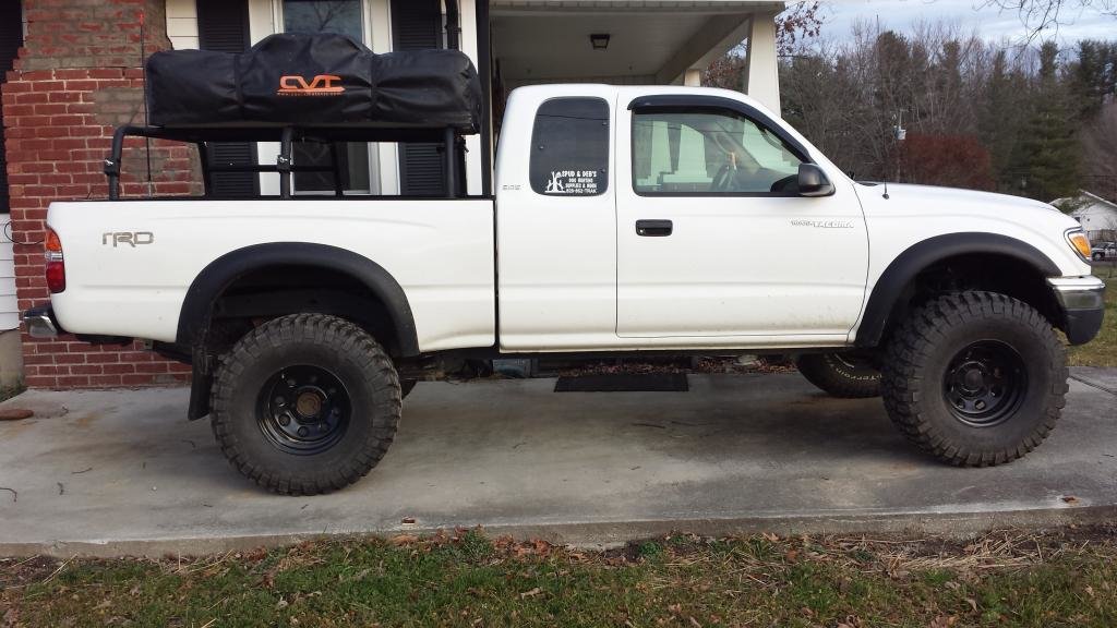

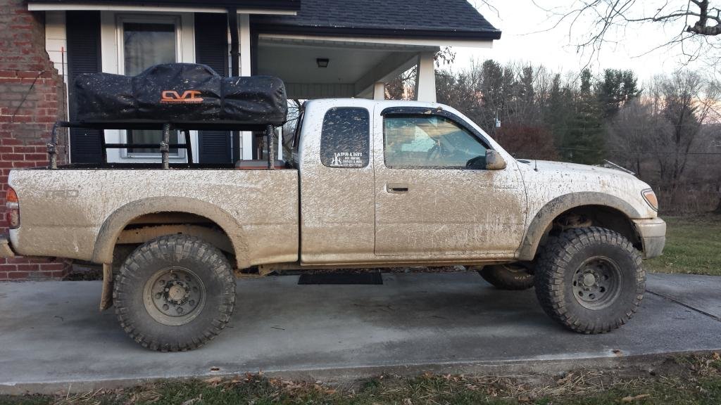

    Finally put in the extra leaf for the Dakars
    Before
    After
  4. Dec 28, 2014 at 2:16 PM
