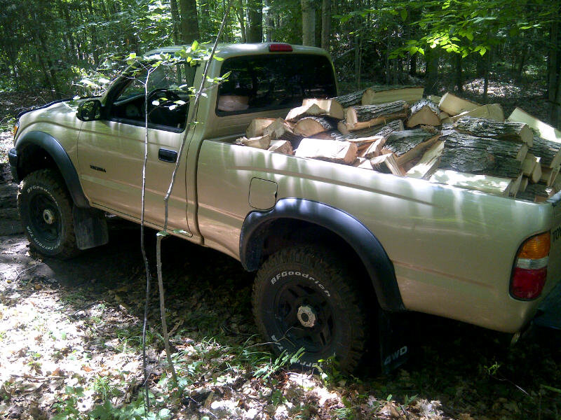

    Blacked out badges-rims OME lift with 881's & dakar pacs, summer tires=BFG 31x10.5x15 on 93 4runner rims,winter= 265 75 16 DURATRACS on stock steelies,Flowmaster exhaust, deck plate mod, ARB front bumper
    I put 881's on mine and dakars with the AAL on the install over 3 years ago. This was Oct 2011 and I then carried 500 lbs of patio stones all winter to settle the leafs...it did not happen.
    I ended up way too high and stiff in the rear and removed the AAL's in the spring of 2012
    I just have a topper on this little reg cab and do not carry a load too often.
    I may put the AAL's back in some day if the dakars ever settle/sag but at this point no sign of that!
    I will post a pic of the truck with AAL the day of install

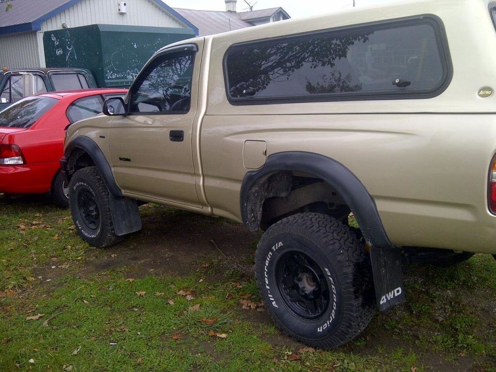

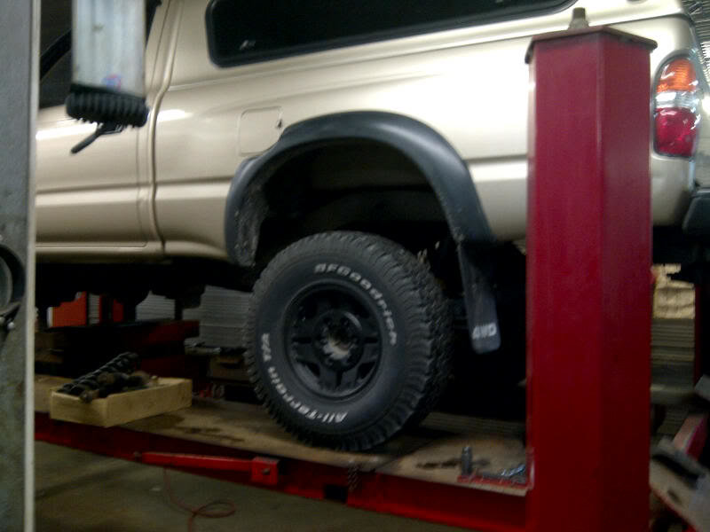

  12. Jan 31, 2015 at 4:51 AM
    #1492
    ontarioyota
    ontarioyota Well-Known Member
    Oct 2, 2010
    #44122
    1,330
    @scott777taco INSTAGRAM
    SW Ontario, Canada
    2001 Reg Cab 4x4
    pic day of install with AAL in
    on the lift that day
    2 years later with AAL out....would have been nice to have it in on this day but only a 1 kilometer drive to the woodshed

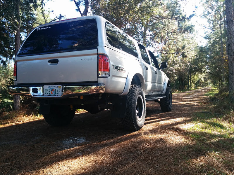

  15. Jan 31, 2015 at 8:28 AM
