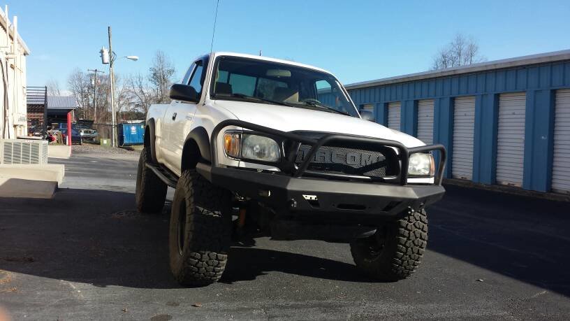

    Blocks maybe :notsure:
    :p
    883s held up well after putting this beast on today
