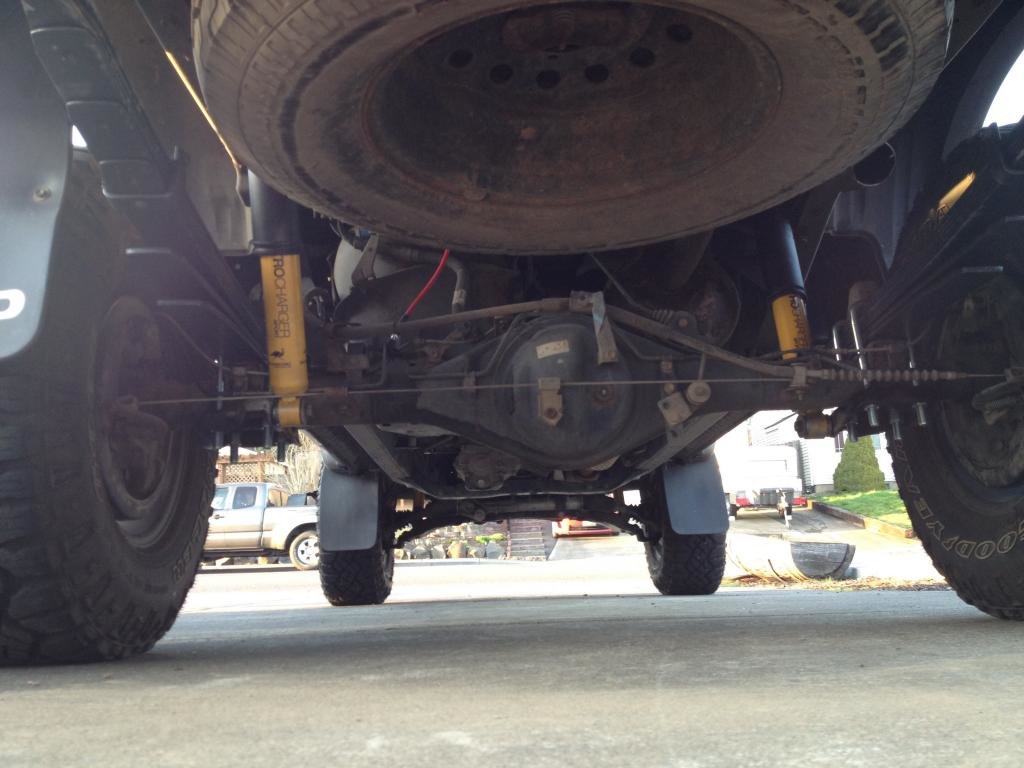

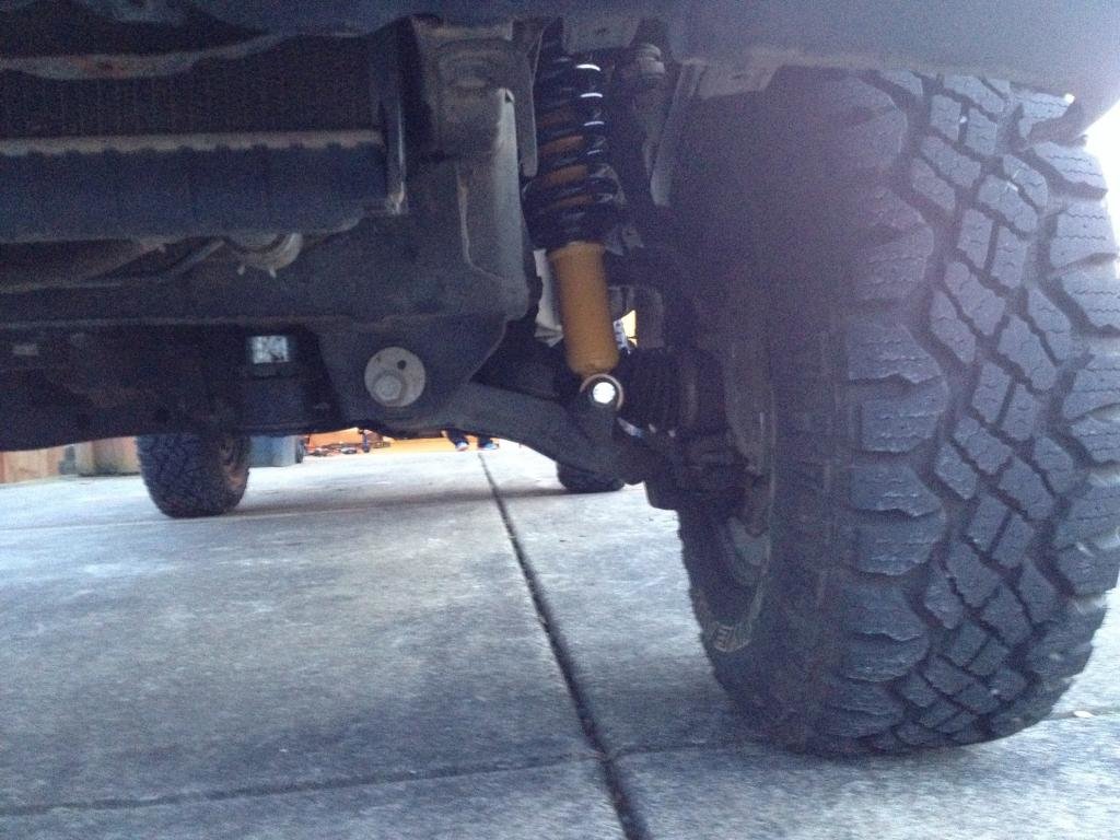

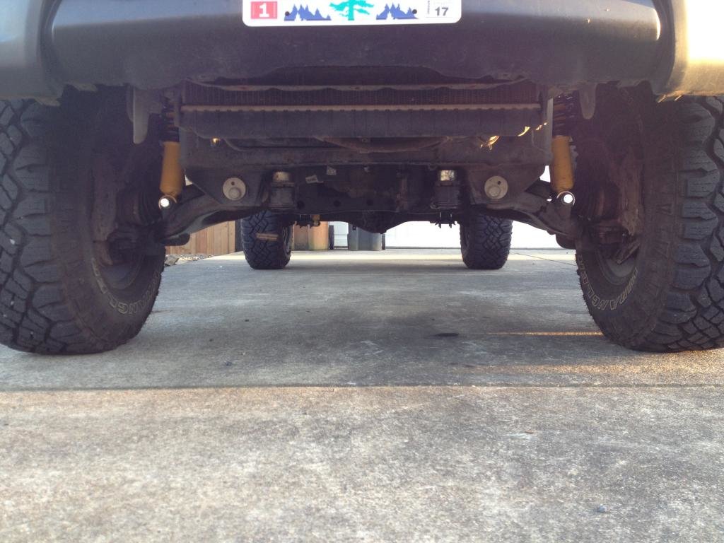

    Had a good Valentine's Day today installing my suspension. I went with 882's up front with trim packer and Dakar springs with D43XL overload leaf. The ride is amazing and is night and day compared to my stock bilstiens with spacers and flat leaf springs.

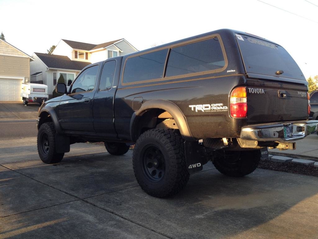

    Now without the topper... :)

    Really nice truck! Where did you get your taillights? And is that an led 3rd as well?

    Took some more pics of my truck with my new OME set up:

    Thanks! Taillights were put in by the PO so I don't really have any info on them. The 3rd brake light are still bulbs.
