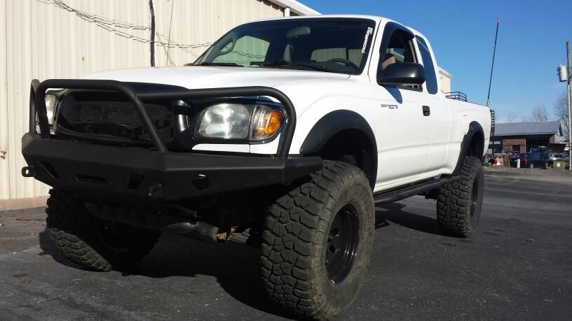

    I plan on ordering the full OME kit with 881s and Dakars w/no AAL for my 04 double cab. How many have had to use a center bearing drop/ shim kit? Just trying to think ahead and get everything I need.

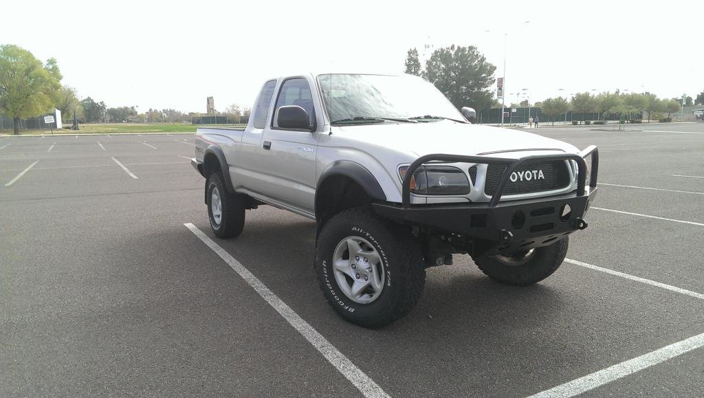

    I'll play

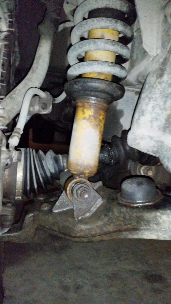

  11. Feb 23, 2015 at 5:59 PM
    #1551
    Scenekyd
    Scenekyd Not much of a member
    Nov 15, 2013
    #116629
    3,624
    Jay
    Hendersonville, NC
    2015 Ford F-250, 2016 4runner Trail
    :eek: better get that fixed!! Mine are oozing out the end of inner boot.. yours look exploded.
  12. Feb 23, 2015 at 6:01 PM
    #1552
    ffirg
    ffirg Well-Known Member
    Jun 9, 2011
    #57975
    4,876
    mike
    Anchorage, Alaska
    2002 Tacoma SR5 TRD 4X4
    It went from oozing to that in about...a week or two. At least from the time I noticed it originally. I'm not gonna worry about it for a while...I have no idea how to change a CV boot and don't really want to mess with it until spring.
    Also I find it odd that the CVs never leaked any grease for the year I had the 883s with no weight up front. Then I add a bumper and they explode lol.

    Oh wait, I forgot I took off the sway bar. THAT's what did it haha.

    As for installing the front coils, (I also have 882's) I removed the 4 bolts that connect the lower ball joint to the steering knuckle on both sides allowing me to push the lower control arm down far enough to push the lower bolt in. I first lightly tightened the 3 bolts up top so I didn't have to push the lower control arm down as far. I did not have to remove the tie rod ball joints to do this. I also removed my sway bar.

    137

    Yeah I'd like to know how to do that anyway just in case I need to do it on a trail too.

    Remove wheel, remove 36mm hub bolt, remove 4 14mm bolts that hold lower ball joint to steering knuckle, pull front hub away removing outer axle, use pry bar to remove inner axle from front diff.

    Pretty much that easy ^ it does take a little finagling though... You'll get the hang of it. And if you seat the seal poorly, you can get extra practice (ask me how I know this three times over).

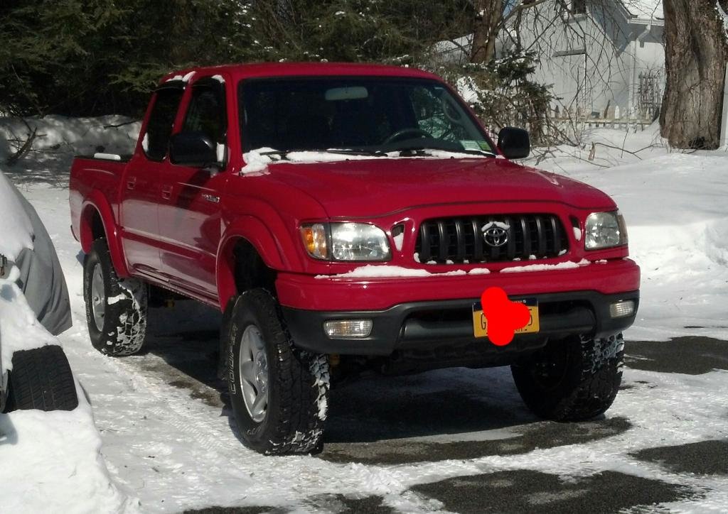

    IMG_20150215_124139_943_zps5xiazhkr_edit_88e7d7b1eb76a2967c95da118d9d7a1c4c0fd02a.jpg
    Wheelers OME
    881's and 10mm enhancer. Dakars
