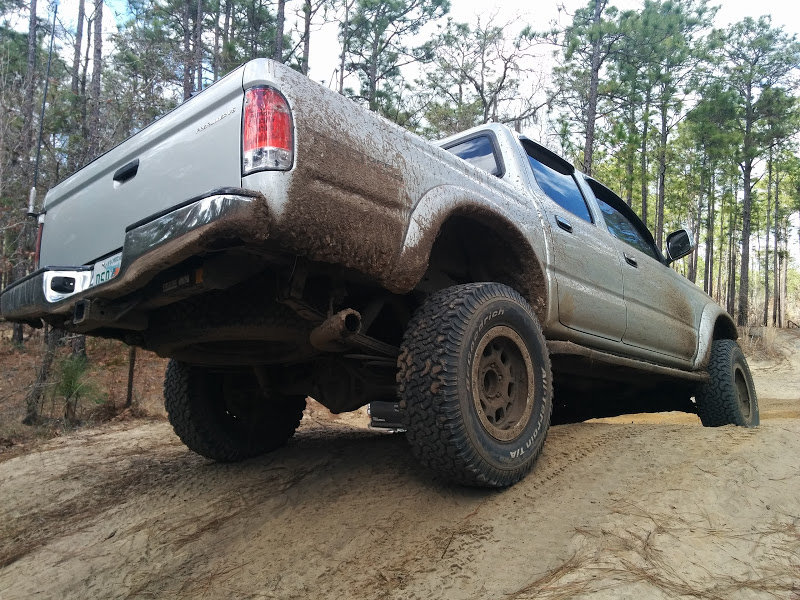

    OME setup worked well this past weekend at a Tacoma meet
