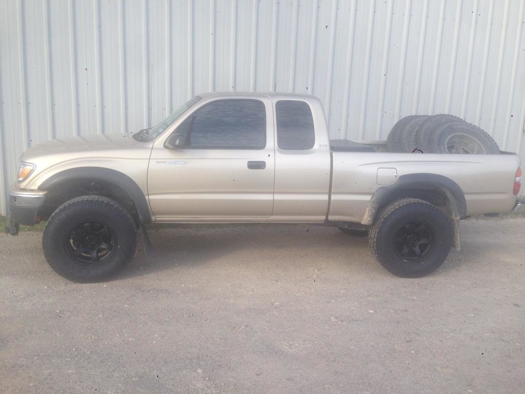

    Here's a pic right before I sold my truck last week. I ran OME 881 with OME struts up front and Wheelers 4 leaf pack and OME shocks in the rear. 31 x 10.5 x 15 Cooper ST's.

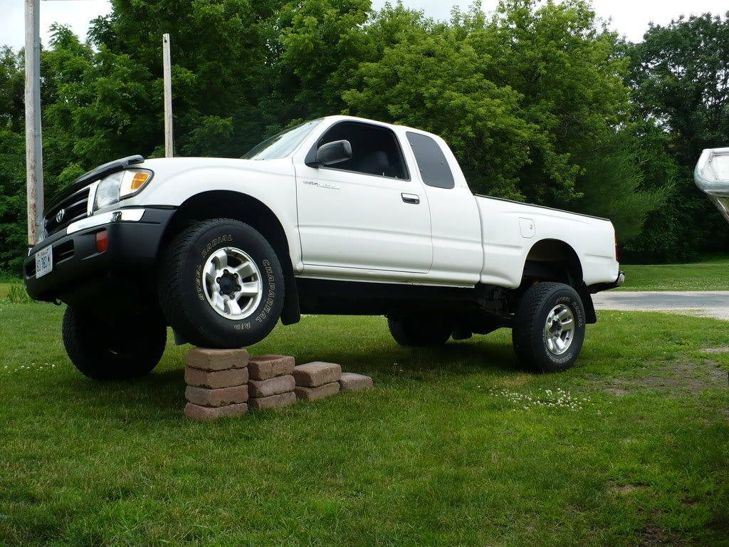

    Testing the flex right after I lifted it back in the day.

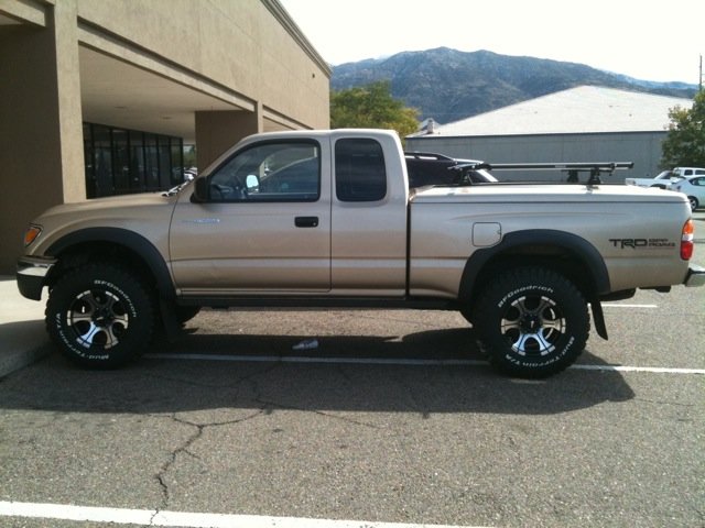

    OME882s on Nitrochargers w/ stock Dakars (no AAL)

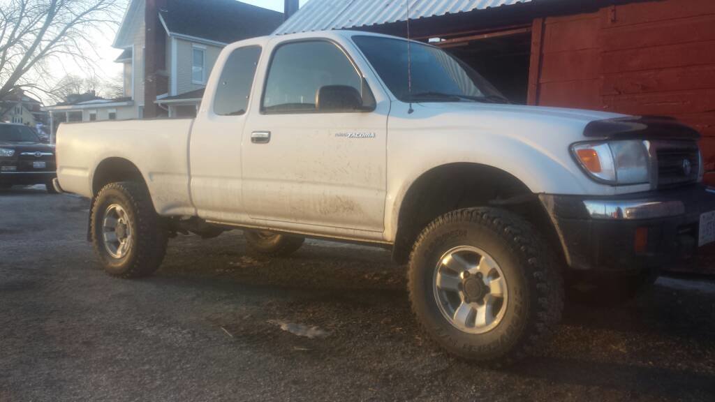

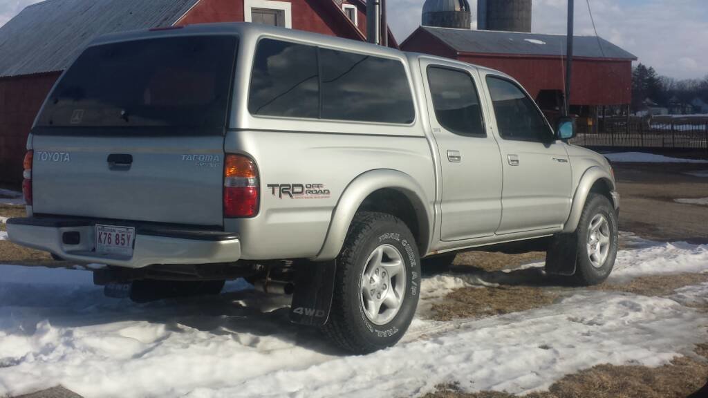

    With the new shoes.

    Is that a current pic or right after install? Good lookin rig by the way.:thumbsup:

    Thanks. That was a few years ago. Just had the MTs put on. The 882s had been on for a few months, the Dakars a couple years.

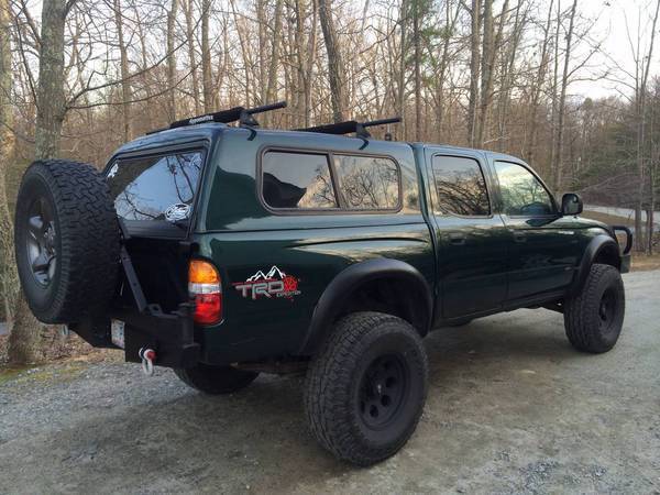

    I agree from experience. I have an 2003 DC with an ARB up front w/o a winch and a camper shell on the back. The front sat about an inch or more higher with the ARB on the front and 882s and the shell on the back. I had to take the shell off until I could get the AAL shipped just to be close to level. Now with the AAL in the Dakars I was able to add my shell, bed drawer system and the CBI with swing away and still have a rake.

    I really like this truck. Looks good man!

    X2!

    Thanks guys!

    Yep wish you posted more yota fish...

    Ha! Not much to see pretty much the basic deal just like everybody else's around here. All the good stuff is on the outside, under the skin is just a plain old truck, nothing fancy for sure.

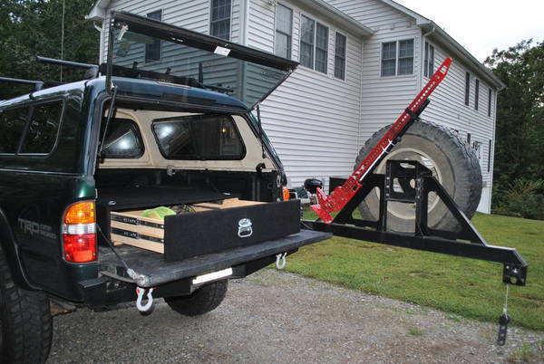

    I guess the term "system" might be a little overkill but these are the best photos I have of it....its out right now and tucked away in a barn. Either way it's homemade but works well for me.

    Cool, I like that a lot. Know who made the hinges? Thinking of doing two sides on mine, one to transport firearms legally (effed up laws in CA) and the other for misc stuff and ammo that I'd like to store and keep dry.
