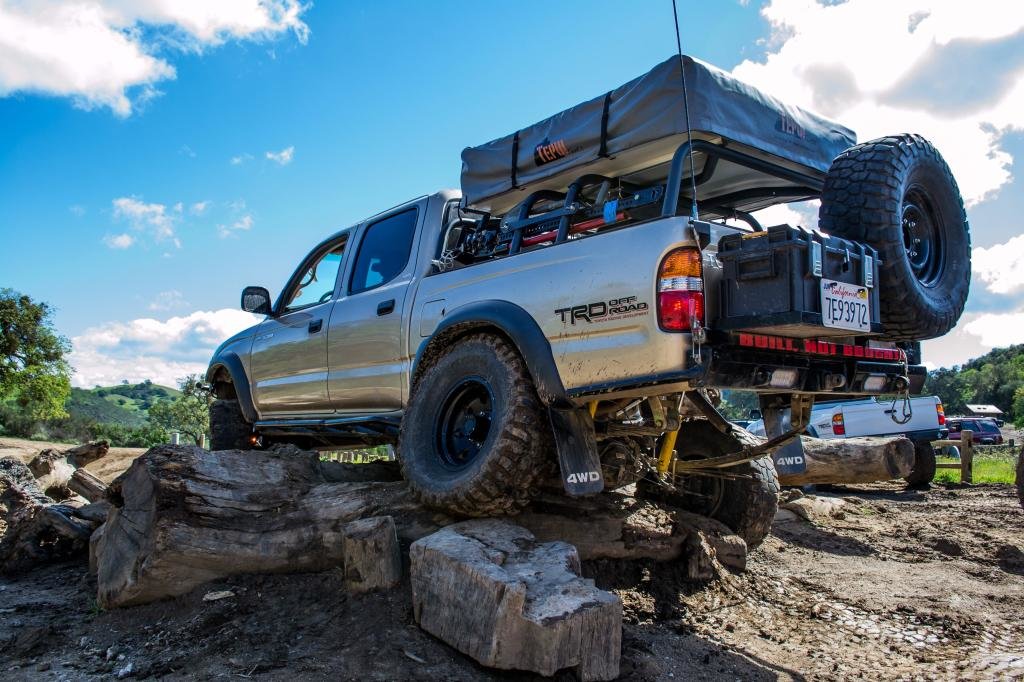

    Since I'm whoring this everywhere else... I'll extend here too... Relocated the shocks, kept the OME nitrocharger units. Definitely added some droop.

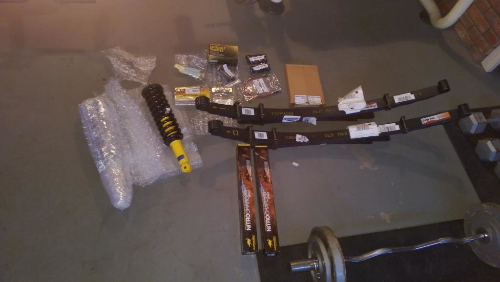

    Finally got my kit for my "new" taco :D

    I plan on installing it when the weather gets warmer cuz its been real old in CO lately. Isn't supposed to come with the trim packer from wheelers? Maybe they have put it on with the in house coil assembly i bought? I will go check!
    EDIT:I actually opened the passenger side shock assembly and i opened the driver side just now and yes it has the trim packer on the seat of the shock under the coil
