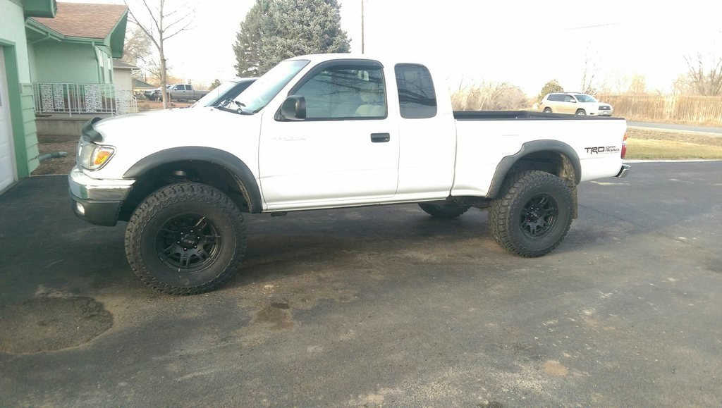

    Ha nice! What tires did you go with? Are you 4x4?

    Yes sir i am 4x4 and LT285/75R16 Cooper Discoverer ST Maxx! They look so much better in person too! :rolleyes:

    Ohhhh how do you like them?? Thats what im looking for next.... Notice a power decrease? How much was the speedo affected?

    I have had them on only since last night but from what i have driven they are a great tire! Honestly its hardly a noticeable difference if any and i came from P rated 265's. Haven't really tested to see the difference on the speedo but i dont think there is much of a difference.

    Very nice... What is the backspacing on the rims you have?

    4.5" BS and 0mm offset. I rub at absolute full lock on the frame and its not even bad and i rubbed the plastic covering the pinchweld but i cut that and hammered in the pinchweld for safe measure. I dont rub the uca and i have a 3/8"-1/2" gap between the tire and uca.:thumbsup:

    Looks good man same wheels I got but in a 15
