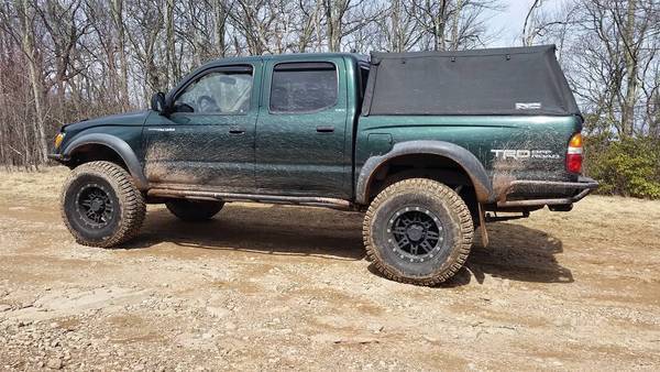

    MadMtnMikey
    MadMtnMikey Well-Known Member
    Aug 22, 2011
    #62120
    1,480
    Richmond/VaBeach
    03 DC 4x4 SR5 TRD
    Dakars out back with 5125's

  16. Mar 23, 2015 at 1:26 PM
    #1676
    MadMtnMikey
    Aug 22, 2011
    #62120
    1,480
    Richmond/VaBeach
    03 DC 4x4 SR5 TRD
    Thanks ;)

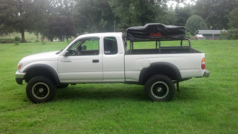

  17. Mar 23, 2015 at 1:34 PM
    #1677
    Scenekyd
    Scenekyd Not much of a member
    Nov 15, 2013
    #116629
    3,624
    Jay
    Hendersonville, NC
    2015 Ford F-250, 2016 4runner Trail
    Old pic. 883s with dakars. No AAL. 265/70. For the person above asking..
