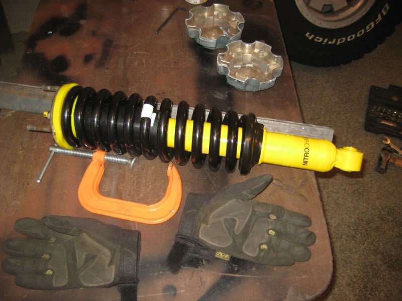

    Those spacers, where do they go within the coil assembly? On top of the top hat or on top of the coil itself, or??

    If it's these..
    they go on top of the top hat, you may need longer studs.

    Swap the leaves, I couldn't live with that.
    It's the jeep Jk 10 mm spacer. The yellow thing.

    ^^^now the spacer that delta posted (if im seeing correctly) is under the top hat correct?

    Yes. That is the Jeep JK pre-load spacer.
    What I posted is a top plate spacer.
