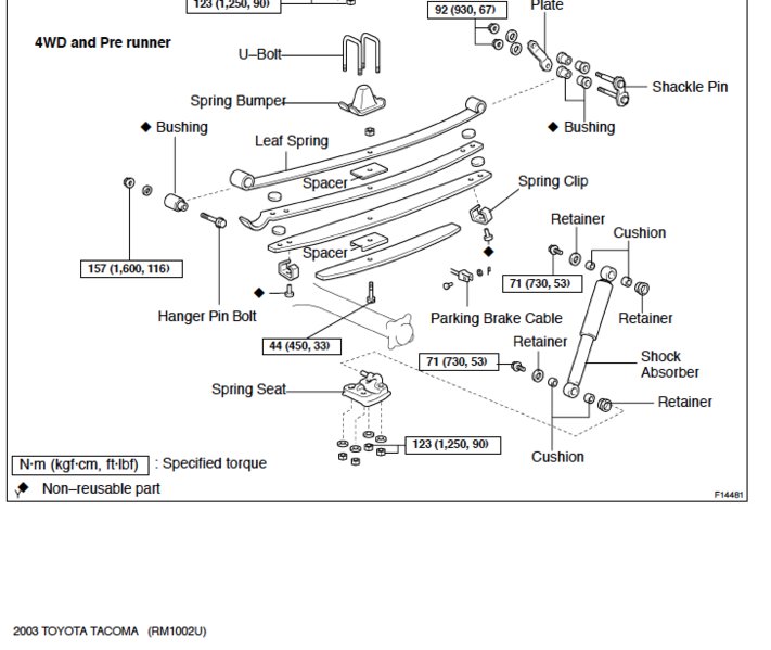

    If i buy them from wheelers what length would be the same length as the other ones that came with my suspension?
  3. Apr 1, 2015 at 10:40 PM
    #1723
    Jiveydude
    Jiveydude Well-Known Member
    Oct 22, 2013
    #115035
    1,324
    Micah
    OH
    04Taco
    Stuff and things that make it better.
    These are the specks:
    OMEU53A:
    185mm(leg length)
    75mm(leg center)
    14(thread diameter)
    65(thread length)
    1.5(thread pitch)
    SQUARE(top type)
    93(required torque Lbs.ft)
    126(required torque Nm)

    Interesting that the diagram and table are different.

    I'll have to dig up my diagram to see if they are the same.
    edit: 90 in my book :confused:

    Yeah, my 2003 FSM shows 90, too. Page SA209.
    Are you thinking of the Hayne's manual? I know they were misprinted somewhere.

    Well son of a... Idk, the one I got was from somewhere on TW, didn't get it from fsm files because I haven't foggiest where in that mess of folders to find it...

    Maybe the one I posted is Haynes... I'll see if I can find thread

    This: http://www.tacomaworld.com/forum/suspension/87093-u-bolt-torque.html
    FML is it a 2nd gen page? Maybe that's where my confusion was. But it looks the same as first gen setup.. I've lifted a 2nd gen with buddy and rear shackle was different..
    Edit.
    It is a second gen page, just noticed while that shackle looks like my aftermarket Toytec shackles, the oem 1st gen shackles have the bolts perm attached on one side.
    This has been a nice rabbit hole. Guess I need to NOT have that saved as important truck info and save jiveydudes instead :)

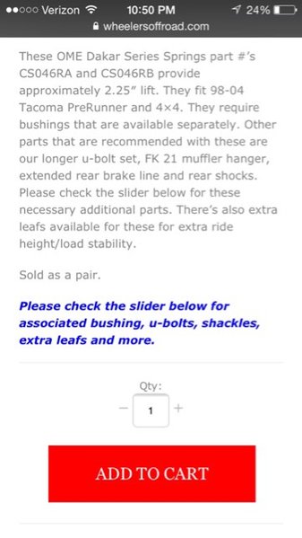

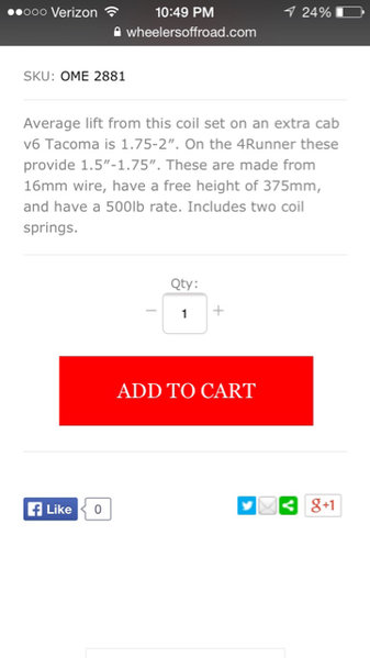

  11. Apr 7, 2015 at 10:48 PM
    #1731
    johnboyTRD
    johnboyTRD Well-Known Member
    Sep 19, 2013
    #112818
    3,226
    John
    South SF bay
    2003 Tacoma Double Cab TRD
    Full ome lift, nitro charger sports all 4 corners (rear shocks relocated), Dakar pack w/ AAL, 882 coils, diff drop, toytec 1" shackles, trail gear low profile front bumper, Tuff Stuff winch, bamf sliders, RAT skids, BAMF Bed Rack, Tepui Kukenam RTT, RAT rear bumper,
    Well the 881 is advertised at 1.75" lift online. The dakar pack is advertised as 2.25". So if you add a 3/4" spacer in front, you'll be at 2.5" lift , giving .25" more lift in front than rear. Your truck right now probably sits .5" taller out back, so you're now (by this math) going to be approximately .25" higher out back. That's pretty level. These numbers in real life may be different, but sounds like you will be in the ball park with what you ordered.
    Hopefully someone who has a similar setup will see this and post a picture with their results.

    Ome 881 specs from wheelers:
    And dakar:

    If the spacer measures .75", actual ride height will be changed by about 1.125" because of the IFS geometry. The placement of the strut in relation to the spindle gives about a 1.5 multiplier.
