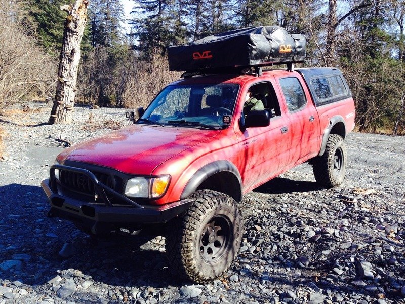

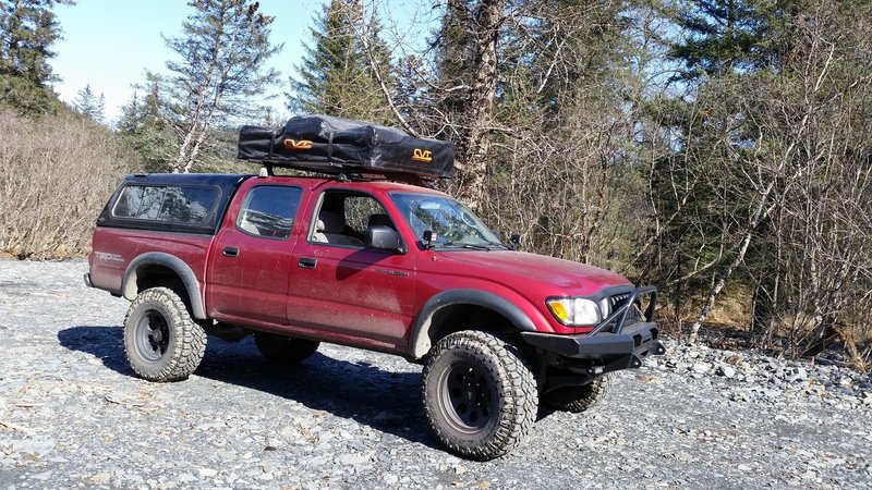

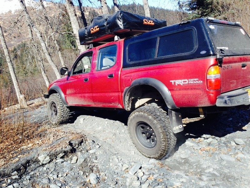

    Speaking of...might as well whore out my truck more since I don't think I've posted in this thread with the shackles and new tires/wheels...

    Truck looks awesome. We have the same wheels :) pretty soon, you'll have to plastidip those center caps. Mine turned yellow. The plastidip matches damn near perfect though and I just sprayed two quick coats when I was rotating my wheels.
