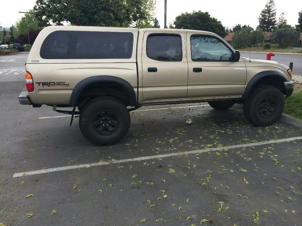

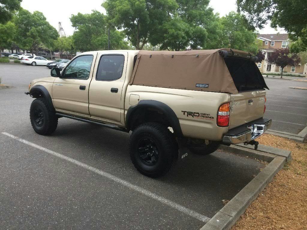

    Ok so here it is at first.. keep in mind I have 1.5" lift shackles here. Holy rake batman:
    It settled pretty quick. Not too long after, still with 1.5" lift shackles.

    Well that is still a lot of rake in my second pic. Either way will be ok, but I think you might be better off with just aal and stock shackle length.

    Yeah holy rake but looks really good after.Those pics are better than the ones on your build thread cuz i dont think they are on there right?

    I pulled those from my build thread :)
    But without the 1.5" shackles imagine where it would be in terms of height. I have since backed down to 1" lift shackles, and with the bumper rack and rtt sitting at 3/4" higher in rear. Prolly drops .25" to .5" when loaded down for camping if I had to guess.

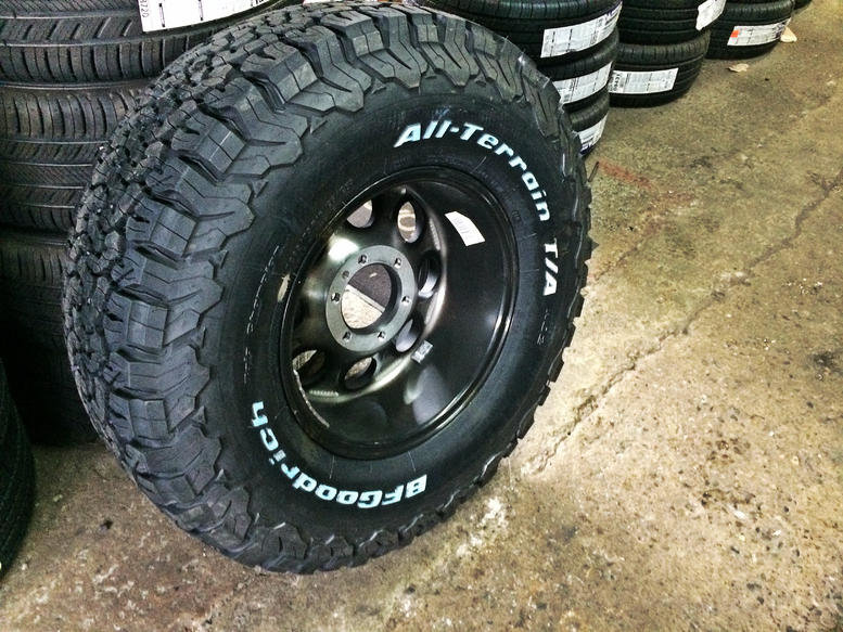

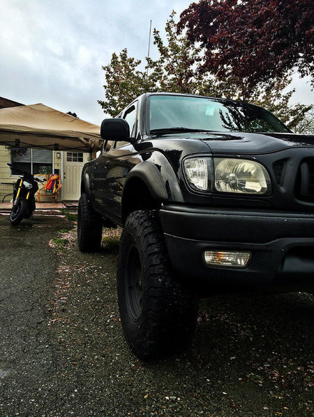

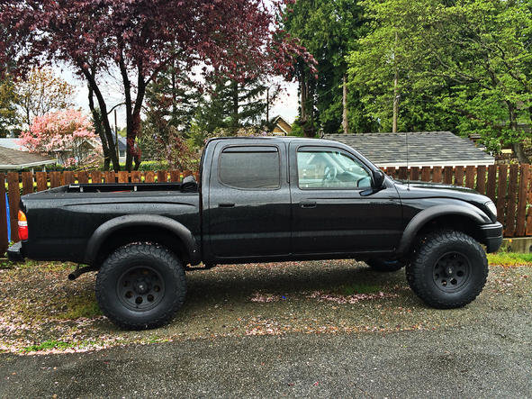

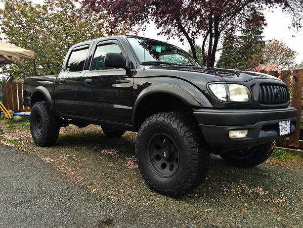

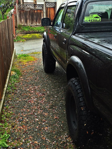

    So I finally got my wheels shipped in. Tires have been layin around staring at me for the past 2 weeks...Torture man.
    I've had the OME suspension upgrade on for a while but I got my wheels balanced and tires mounted up today, and I couldn't be happier.
    881's with 10mm spacer
    Nitrocharger sports in all 4 corners.
    Stock leaf springs with 1.5 inch AAL for now. Dakars in the future.
    Sitting pretty much level which is what I wanted, no weight in the bed however.
    285/75/R16 BFG T/A KO2's
    Pro Comp 7069 Matte black alloys. (16x8 -12mm off set, 4'' backspace)
    :D

    Nicely done, always like the blackout look.
