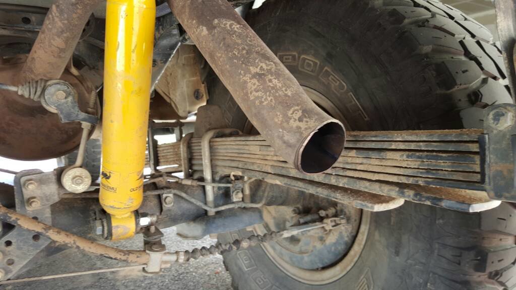

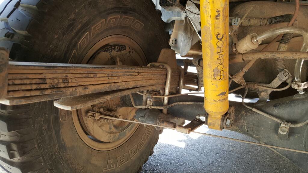

    So here are my springs when loaded for camping and wheeling. I think I need to address this.
    531f42bf9e38289f95b8361852c267c9_e3429cd97cf1642cb8e1ecf1b217ad0745819f93.jpg175edc52523471838f46ecb127725f51_4a66bca396a20cd7d78015798fe1acfb9010140f.jpg
  10. Apr 26, 2015 at 2:30 PM
    #1830
    ffirg
    ffirg Well-Known Member
    Jun 9, 2011
    #57975
    4,876
    mike
    Anchorage, Alaska
    2002 Tacoma SR5 TRD 4X4
    Mine usually ride on the overload for camping. Nothing out of the ordinary for Dakars as far as I can tell.

    Have you guys weighed your trucks? I am curious how much you weigh when you got negative arch like that.
  14. Apr 26, 2015 at 7:08 PM
    #1834
    ffirg
    Jun 9, 2011
    #57975
    4,876
    mike
    Anchorage, Alaska
    Negative. I'd love to though. I don't think a weigh station would let me, but I've never tried. :notsure:
    I'd guess I have 150 lbs from my shell, another 100-200lbs of wood, and probably another couple hundred lbs of beer alone....jk, but at least one hundred more pounds of all my gear for the weekend. Plus the RTT which isn't sitting directly above the springs but still affects it.
