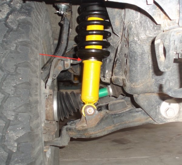

    It goes here:
    I was told to use molybdenum based grease, so that's what I've been using.
