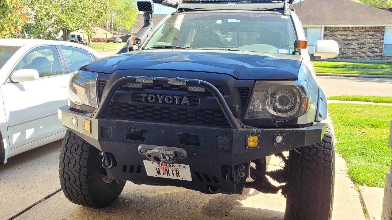

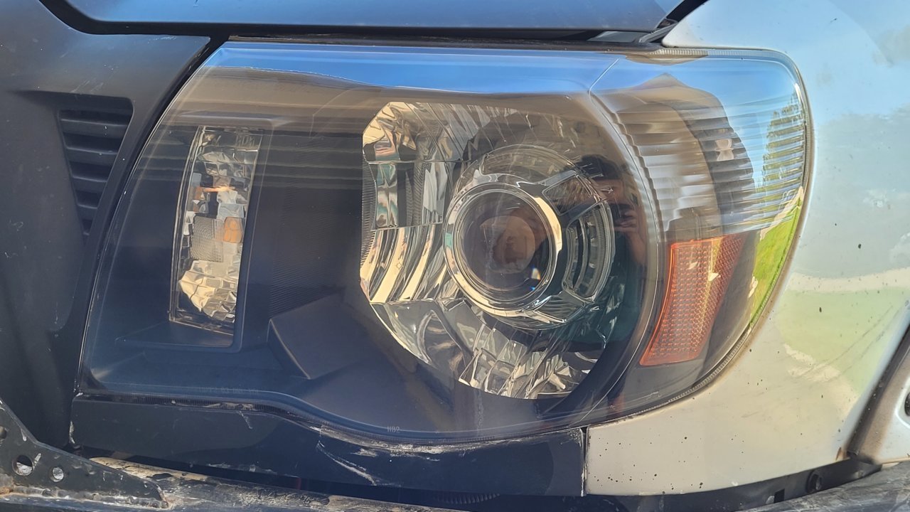

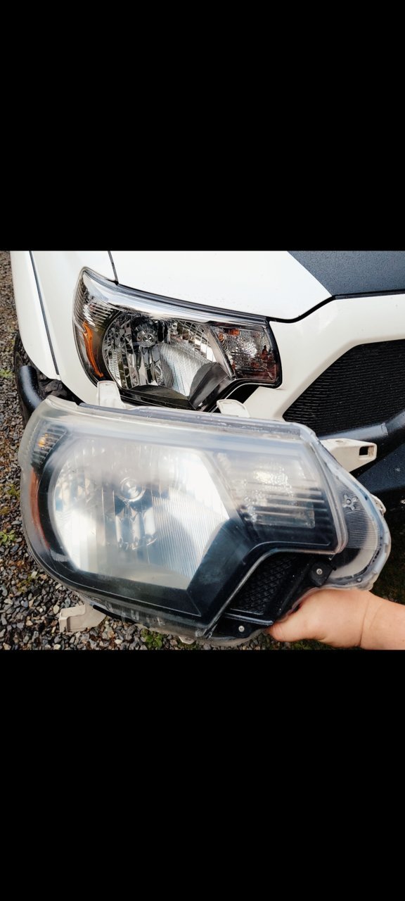

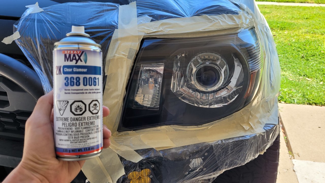

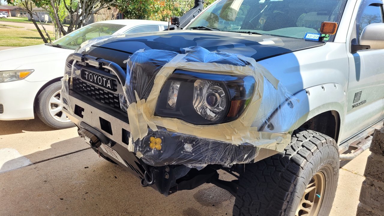

    800 grit-1500-2000 and wipe down lenses really well with alcohol or wax/tar remover. I used a whole can for both headlights. 3 lighter coats with a few minutes in between and I lay it on as thick as I can with the rest of the can

    I also retrofitted stock housings with projectors, resealed them, DA'd them up to like 800-1000 grit, cleared them with a 2k clear, sanded up to a 5000 trizact pad and then buffed
