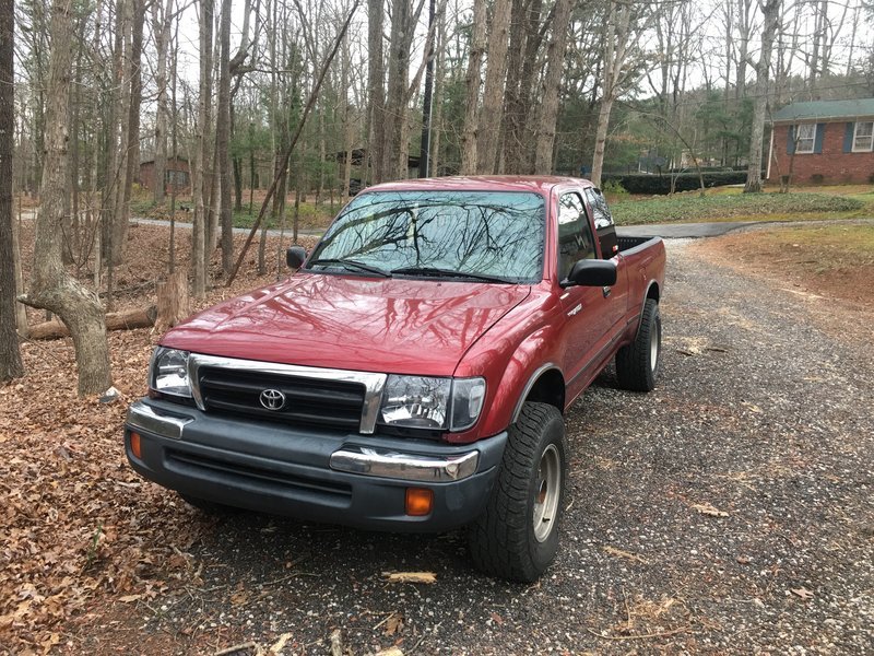

    The more I look into it, the more I am convinced that the ARB Old Man Emu Suspension System is probably the way to go. My practicality has overcome my adventuresome/ wild side. With that said, I am having to put some things into consideration.
    I think I want a full OME suspension system because of the reputation thus far but there seems to be several different thoughts on some of the options they have. I don't want a heavy front bumper but I will eventually have one with a winch. I plan to have 32" or 33" narrow-er tires. Tell me what you think about the options below. Also let me know if you see anything missing.
    OME - 882 or 883 front coils? - people complain about 880 and 881 sag.
    OME - Nitrocharger Sport Shocks
    Toytec, Wheelers, or Other - 10mm Poly or 13mm Aluminum? Upper Strut Plate Spacers for 883's?
    OME - Smaller "Trim Packer" under coil seat spacer on drivers side to alleviate Toyota driver's side lean
    Toytec, other - Front Diff. Drop
    OME - Dakar Rear Leaf Pack with OME AAL
    OME - Nitrocharger Sport Shocks w/ stone guards
    OME - rear greasable shackles
    OME - Bushing kit for Leafs
    OME - Rear Leaf "Trim Packer" to alleviate Toyota driver's side lean

    I am now toying between 881's (with spacer) and 882's without spacer.
    The coil adds some lift. ARB advertises between 1" and 2" depending on the coil (with the 880 and 881). The added spacer increases essentially the thickness of the spacer. So, both add lift.
    The higher you lift with coils and spacers, the more angle on the 4wd shafts to the front wheels. The more angle on these shafts = potential issues. So, much over 2" of lift in the front, you are bound to experience issues if the diff isn't dropped. I am no guru on this either but this seems to make sense.
    I can't speak for the leafs and shackles. I plan to just replace it all.

    I pulled the trigger on the OME kit about a month ago. I hope to pick it up from @SoutheastOverland this Friday. Check them out, very helpful and great customer service. Glad they are so close by. http://southeastoverland.com/
    The set up:
    OME - 881 Coils
    OME - Front Nitrocharger Sport Shocks
    OME - Dakar Rear Leaf Packs
    OME - Rear Nitrocharger Sport Shocks
    OME - Greasable Bushing kit for Leafs
    OME - Exhaust Relocation Drop Bracket
    OME - U-Bolts

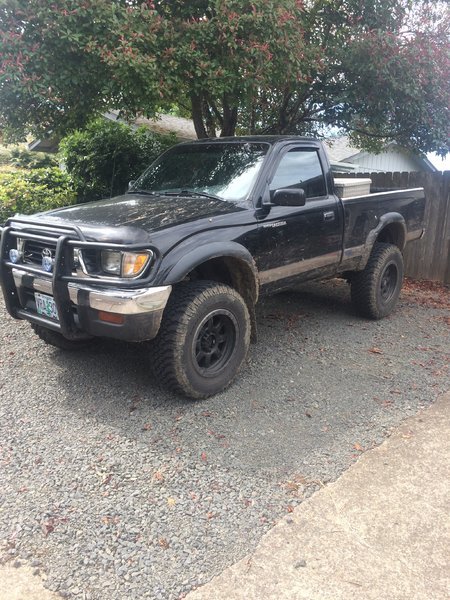

    Mar 14, 2016
    #181241
    125
    Tyson
    1997 Tacoma 4x4 Single Cab
    3", wheels, tires, old man seat covers
    Good looking truck. I was going to give a couple cents on your tire and wheel search. (I used to work for a local tire shop). We had a set of 255/75/17 BFG MT take-offs (used) from a newer jeep so I mounted them on some 17 inch fuel wheels and slapped them on my truck. I must say I love the way it looks. I was afraid it would be too much wheel and not enough tire but it turned out ok. They are basically a narrow 32 inch tire. They are indeed a mud terrain so they are more off road minded but they work well for what I need. I don't think they're loud and mine ride pretty smooth.
