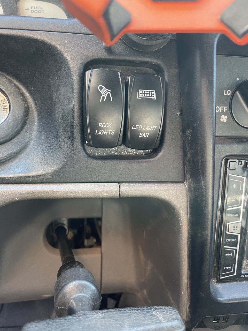

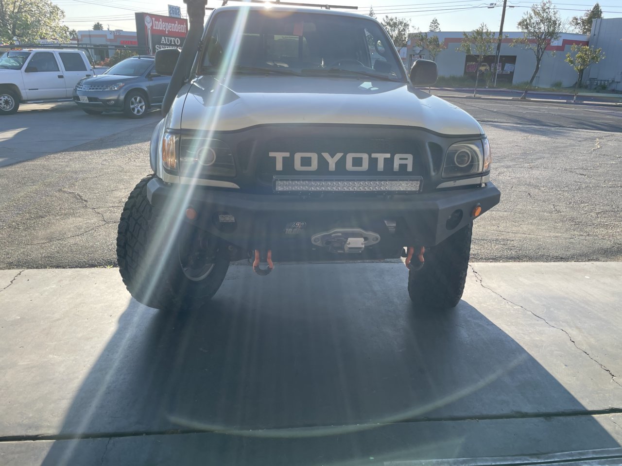

    Got some rock lights and a cheap light bar installed for some extra light this year. Also picked up the paranoid fab clock replacement for the switches. 28DABB7E-3711-4891-9778-710A1F34B4EE.jpg DA379D2B-0A46-465B-A1AA-EE9A43C0F0C7.jpg 39820639-89F6-4E75-85CF-7358BB14BE94.jpg

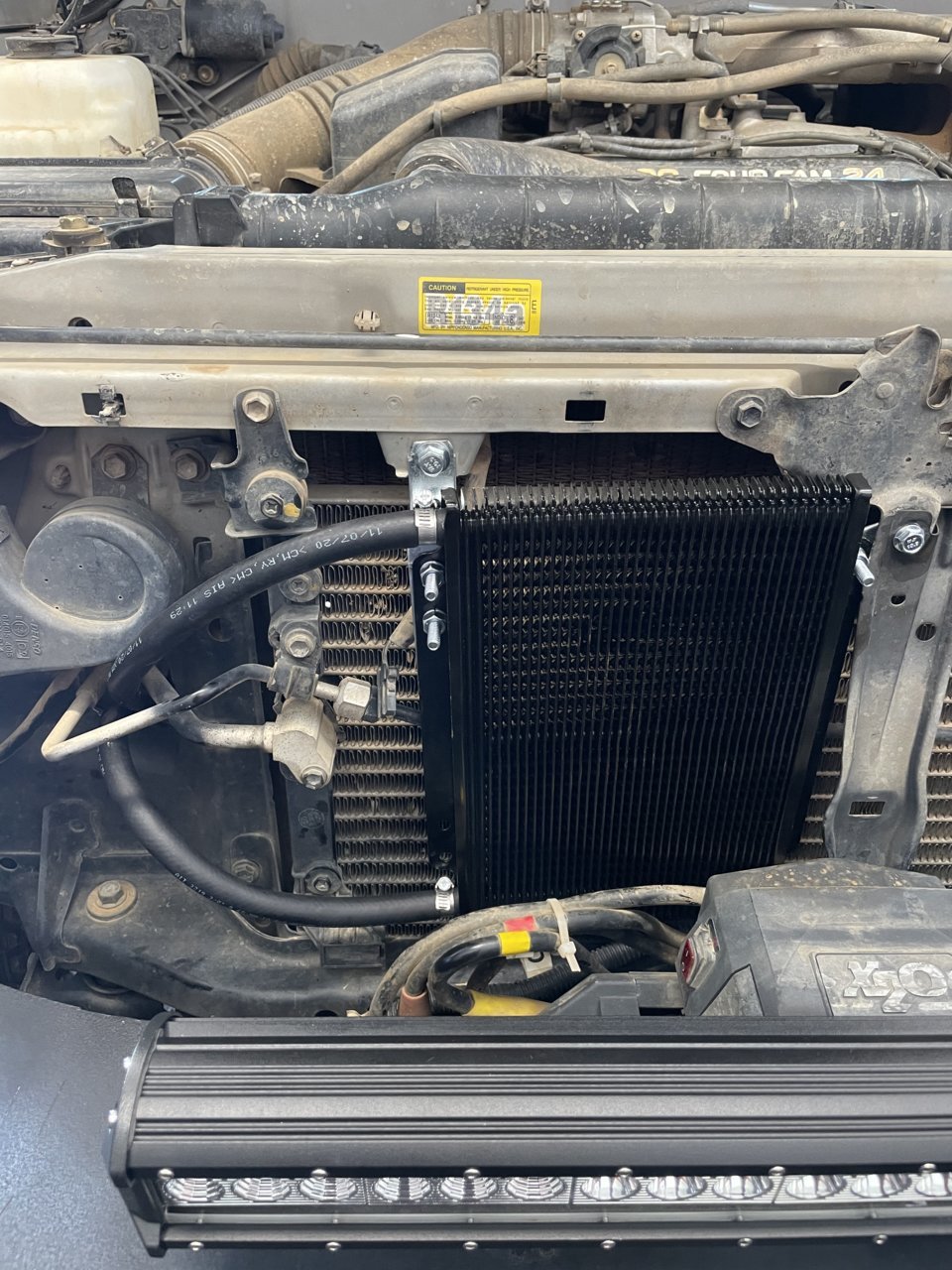

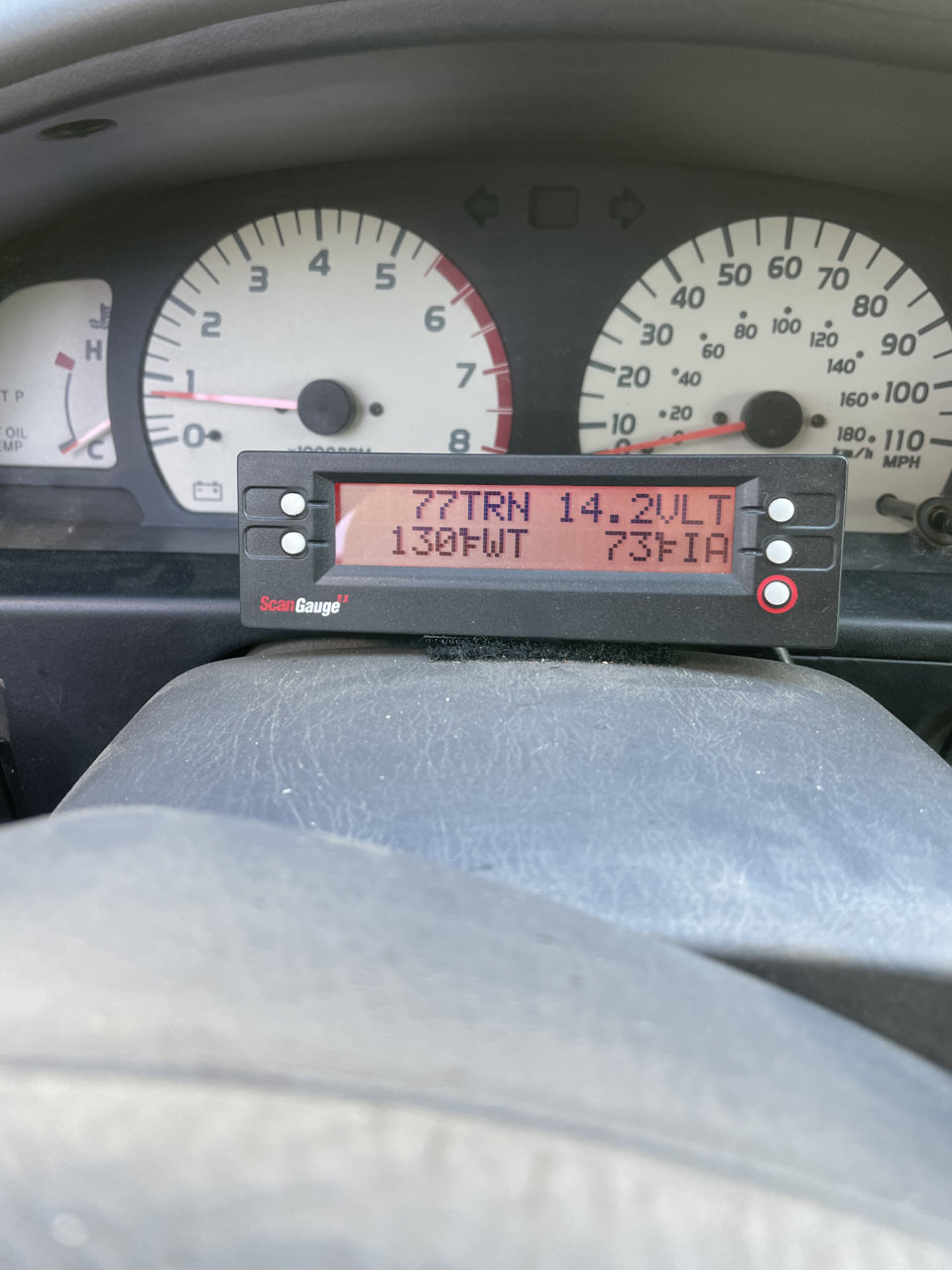

    So since getting my scan gauge I’ve realized my tranny was running pretty hot, so to combat that I replaced the new oem HD fan clutch and a true cool trans cooler. I plan to drain and fill the fluid next week. EFFCDBB5-37F2-4805-9B7A-9704F3CDECDA.jpg EB13CEE3-B053-47E5-AB95-2BD859C2D138.jpg 4BEADFE6-700B-4934-A1C5-793FF0892BA5.jpg

    Drained and filled the tranny today. The fluid definitely needed to be changed.
    Really want to get the alternator installed this week, but I don’t think I’ll be able to get to the big 3 upgrade as well.

    Lol ya ya whatever lol I’m running cooolll AF now lol ready for the summa heat

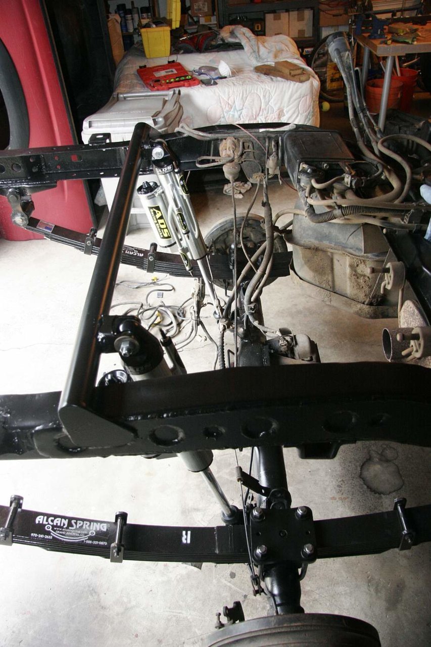

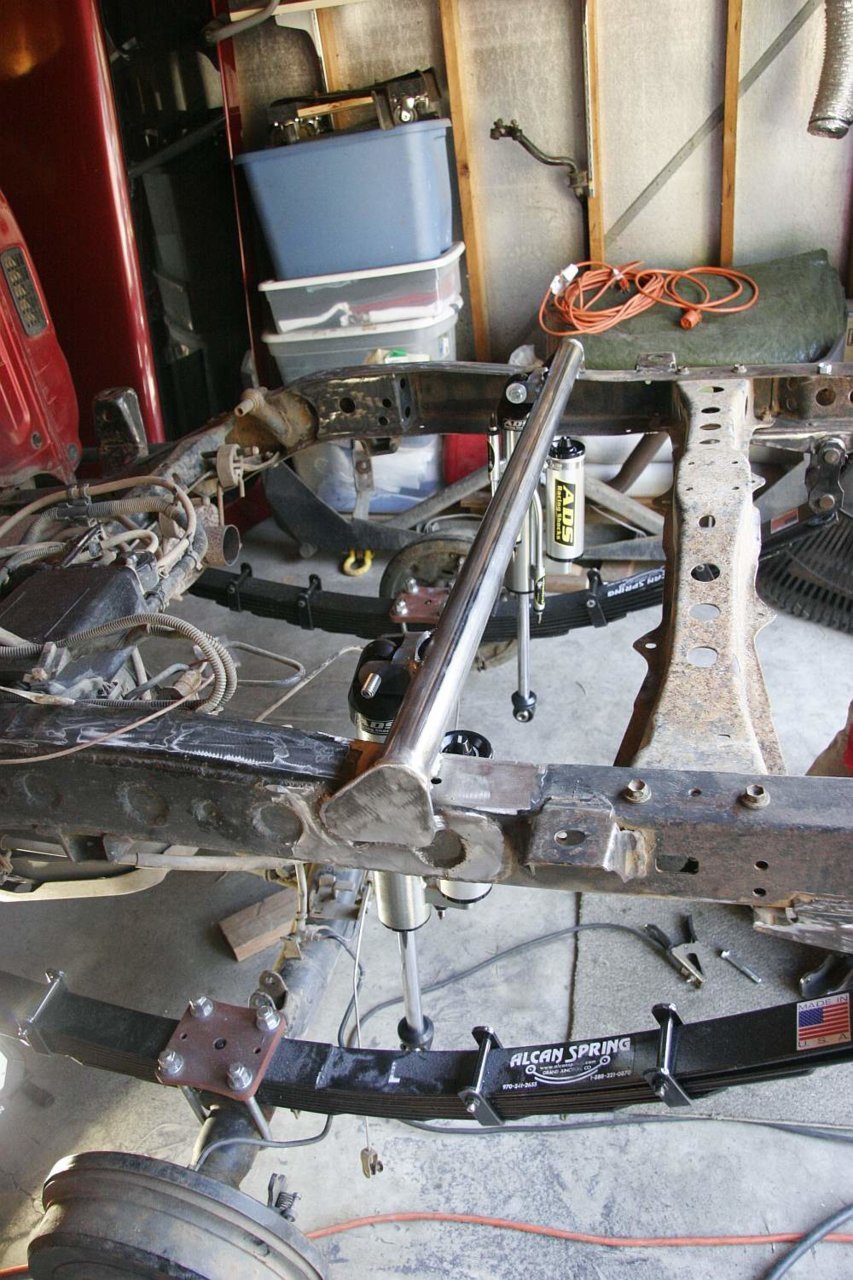

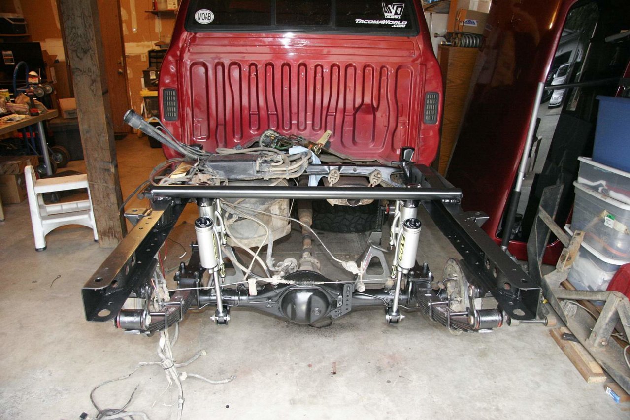

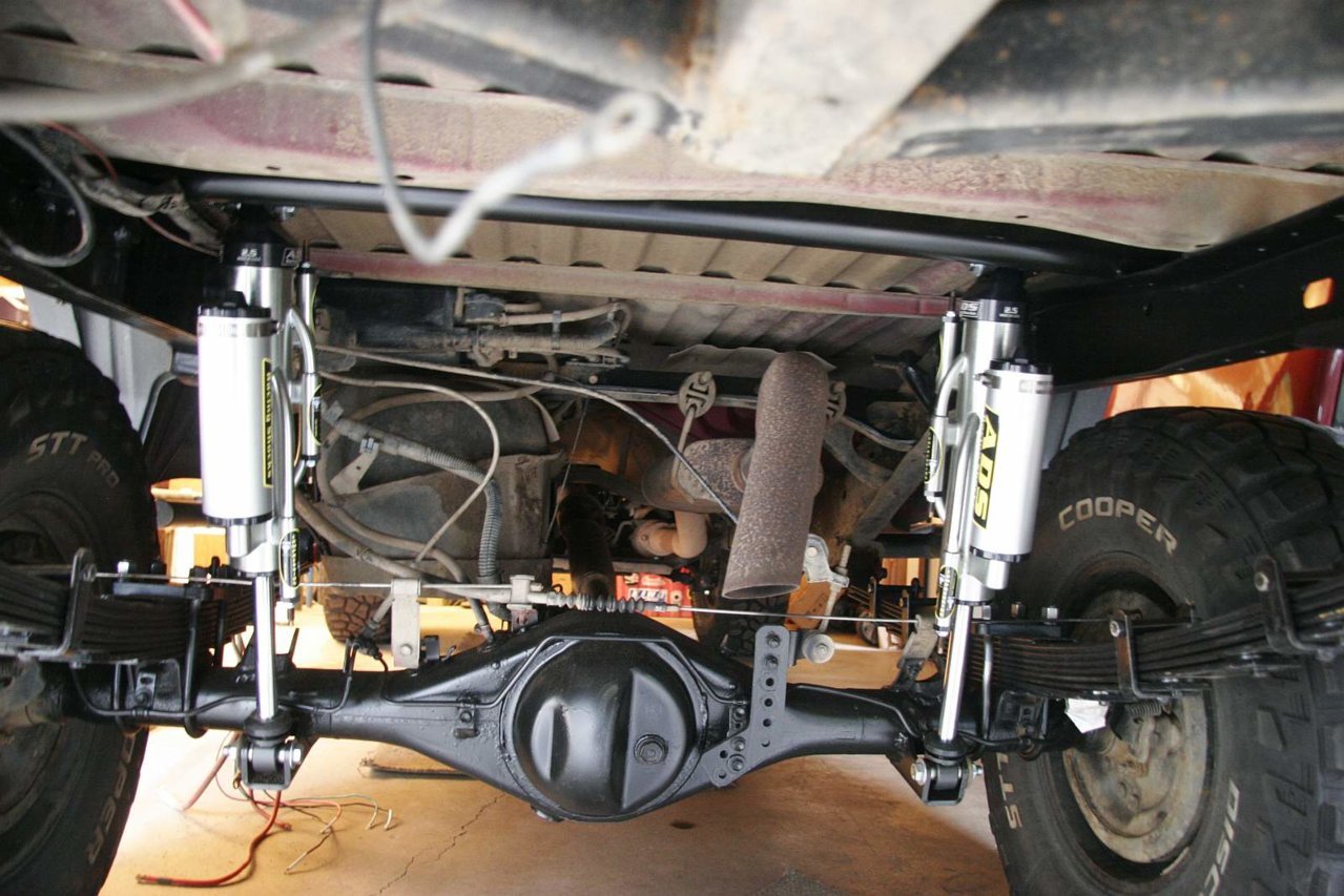

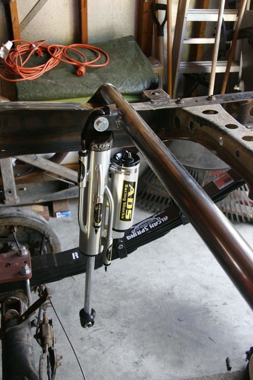

    @Digiratus hey do you have a picture of your rear relocation and the ads triple bypasses? Also what made you go with bypasses and not resi with click compression?

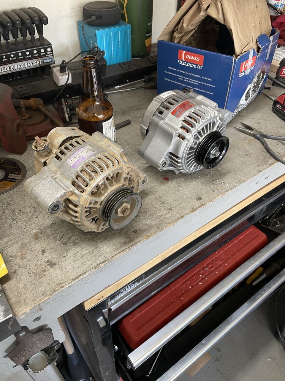

    A question Dan,
    So that Denso alternator looks like a straight bolt in? Is it the one that would come with the stock Tow package? Looking for a back up for mine, sadly I don’t remember the brand, maybe a mean green.
    Props on the rig, looking good, functional and solid. Like the rear bumper!

    It’s a straight bolt up, moves the positive and plug to the bottom is the only difference. Here is the reference page about it:
    https://www.tacomaworld.com/threads/1st-gen-105-amp-bolt-in-alternator.630459/
    Our trucks at highest have a 80 amp alternator which is what my truck has, this one is 105 amp and has a higher charging voltage. It’s from a different vehicle.
    And thanks!

    I don’t want a MT either. But what I’ve learned, more recently that you got to manage the heat of the AT. A scan gauge helps figure out if that’s an issue for you. A trans cooler is a cheap and easy upgrade that I should have done years back.

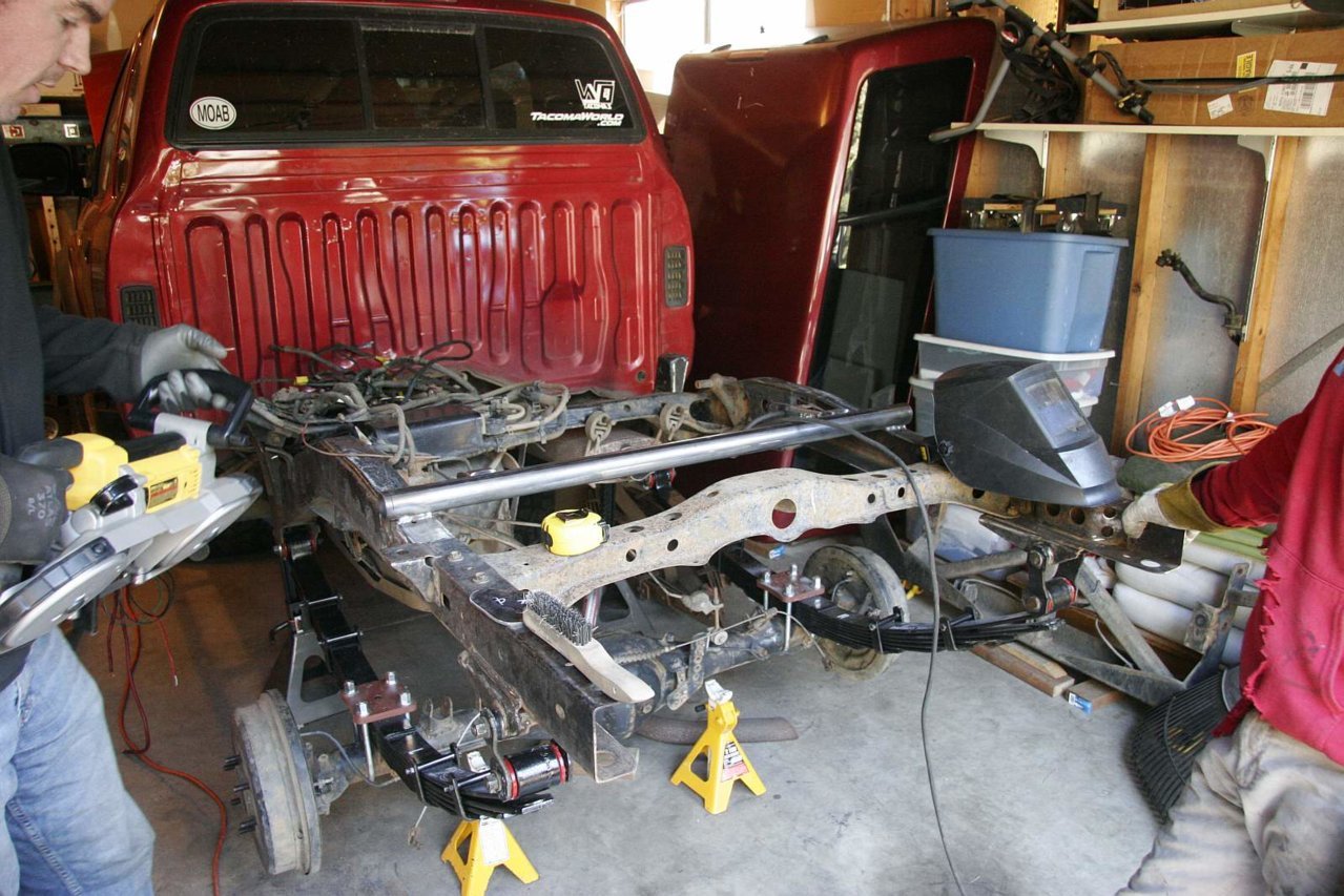

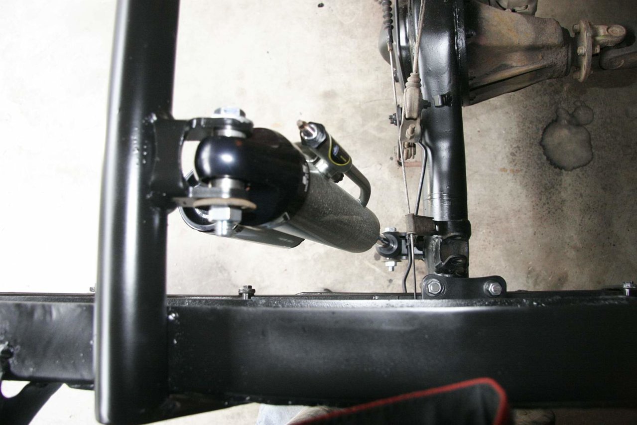

    I kinda fell into that deal. I had been talking with Matt about "short body" 10" stroke rears with resis and clickers. I knew that ADS was starting to make the short body spec for our application. He asked if I was interested in a bypass type instead. He had a set setup with the correct length and all and offered it at a great price. Unfortunately, I've heard they've gotten quite a bit more expensive since then.
    It is important to note that these bypasses add tuneability for rebound as well as compression and they incorporate a hard mounted resi. And it all fits within the space available on our rear suspension.

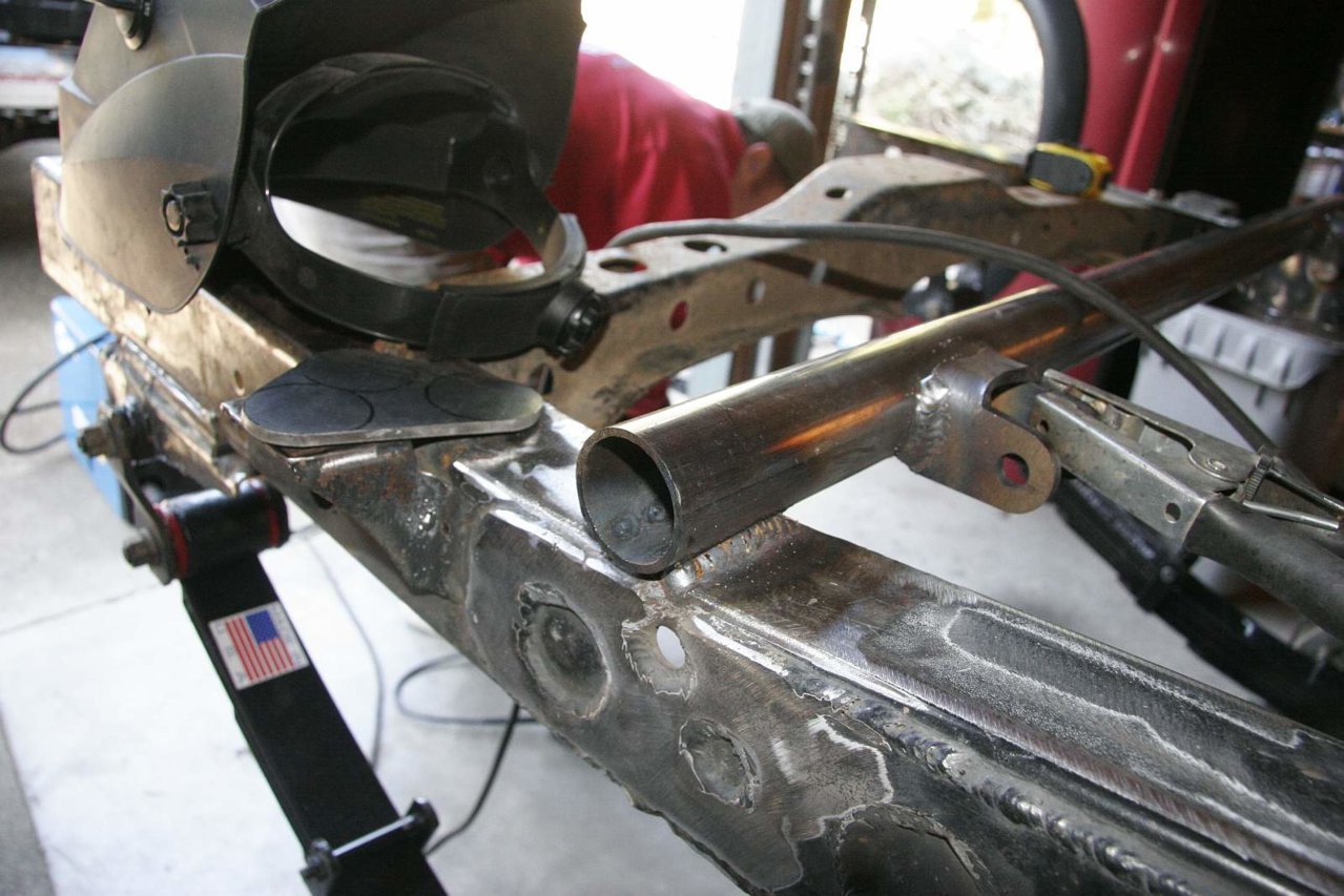

    Any reason why you didn't box in the frame while you were there? Just curious, but I'd assume it was due to time constraint

    Based on recommendations from others that are smarter than me about such things, we decided it wasn't necessary since I already have the Mercer Fab outer frame reinforcement plates.

    And is that 1-1-2”x0.120” dom that you used for the cross member? Any complaints on the bypasses? I’m thinking about pulling the trigger on some rear shocks soon to get my suspension done. The bilsteins don’t pair well with the ADS fronts

    We just used what I had around. I just went and measured it. The O.D. is 1.75"
    The only complaint I've heard from users of bypasses is that they can be a bit noisy. I've learned to ignore the clicking they make on the trail. As for performance, they are pretty awesone and kinda fun to play around with, getting them adjusted. They definitely play nice with the front.

    Excellent, that is a good option to ponder. The higher charging voltage is a good feature to be sure, definitely help with the AGM battery.
    I’m still on the fence between the 3 options (now 4) but I think this narrows it down to either a Cadillac alternator or maybe this one, unless I can fit a tow package alternator from a second gen in there.
    So far the Cadillac is in the lead based on cost and capacity.
