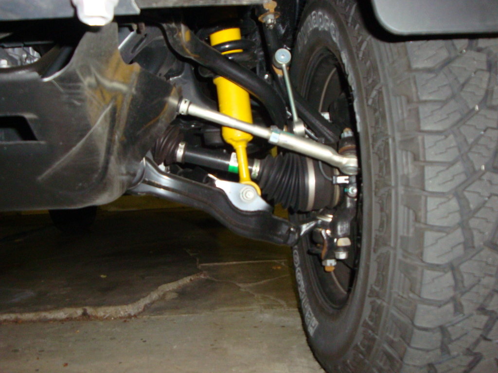

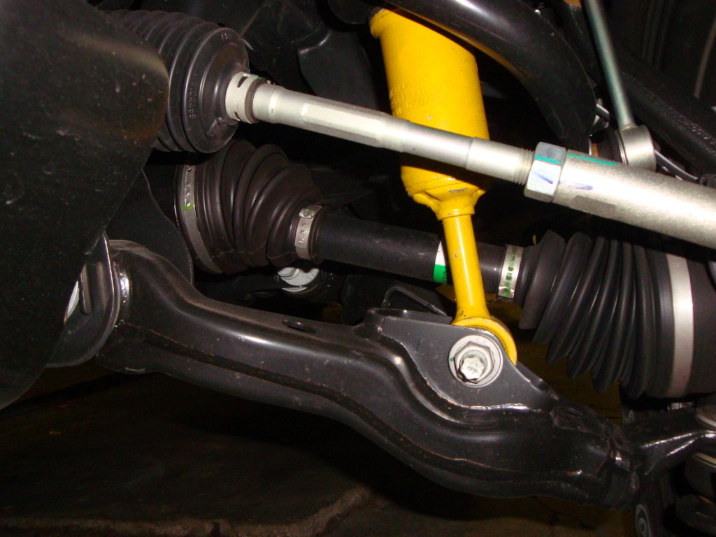

    I measured h/f on the front of my truck and I'm 24 1/8...isn't this 3.5" of lift? might be time to take the top spacer out!! My CV's look stressed a bit too, or at least the fins are touching, here's some pics.

    i dont think you need the top spacer

    Yep , you're at about 3 1/2" of lift

    Yup, getting it taken out very soon. I knew something was up when I parked next to another Tacoma at work that has a 3" lift and 33's and my front was higher with my 32's.

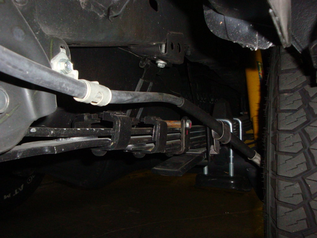

    I have another question on the rear. I have the wheelers 3 leaf progressive pack installed on top of my tsb pack (7 leafs total) and I'm looking at all these clamps that the installer put on it. I think they overclamped my shit with a clamp on almost every progression. Is that right?

    That should help with axle wrap
    2nd gen Dakars have 3 total as a comparison

    okay, thanks. I have 6 total on each leaf pack. Do you see any adverse affects of so many clamps? My first thought would be limiting flex.

    Possible that you would limit flex , although the look open and not bolted tight , more intended to keep the leafs aligned IMO
    You could pm Old Man Doug , he would have some input http://www.tacomaworld.com/forum/member.php?u=19185

    That's true 2 are closed and the others seem as you said to just keep them aligned. Thanks for your help OZ, I'll hit up OMD and run it by him as well.
