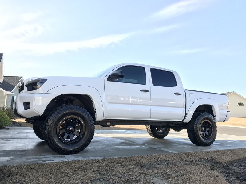

    Bad ass! My favorite color next to Silver.
    Does your truck sit lower on the drivers side?
    Looks great! Nice wheels.
    Does your truck sit evenly in the front? I'm worried that I will get too much lift if I use the 887's with the 1/4" top plate spacer on drivers sdie.

    That was before spacers. After was right about 2.5"

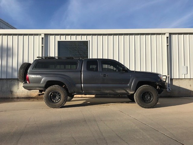

    Thanks! Yep there was still forward rake even with a 1/4" on the drivers side (with dakar leaves in the back).
    I've since changed up the wheels and added a bit of weight to both the front and back and still have some forward rake. I've put about 60k on the OME setup so sometime in the spring I'm going to replace everything and go with HD dakars and 1/4" on the passenger and 1/2" on the drivers to level it out a little more.

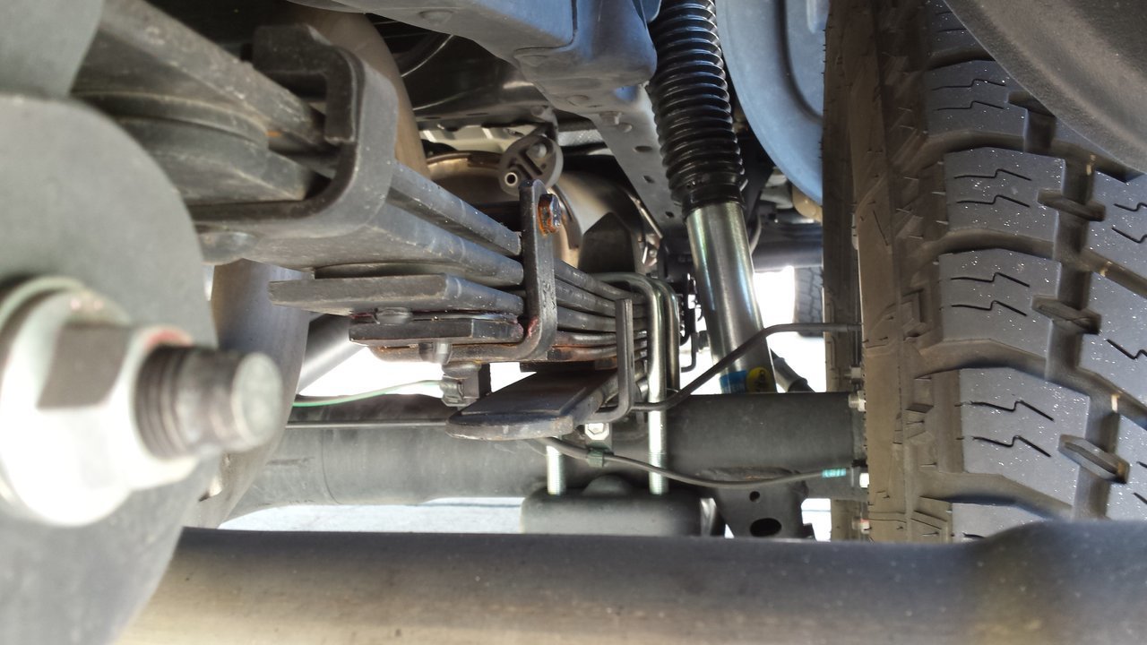

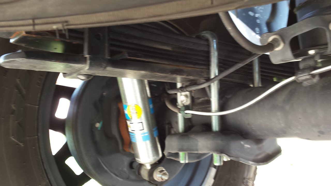

    Bilstein 5100s and wheelers offroad 3 leaf progressive AAL Overload leaf left in.
    doityerself[QUOTED] likes this.

    I'm looking at the 885 or 887 coils but maybe the ome shocks as well and the 3 leaf AAL. Looking for info on how level that would be. Don't want nose up. Minor rake is ok. I have safety recall leaf springs.
    Your truck looks good. May have to look closer at Bilstein..

    885 you'll be close to factory rake and can keep the stock UCAs, 887s will be close to level but not quite, tail is still up a bit but I'd recommend changing to aftermarket UCAs for better alignments.
    For that extra 1/2 inch in the front and better alignments you're looking at another $500.

    Yep, total chaos.
