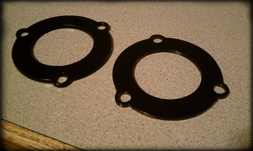

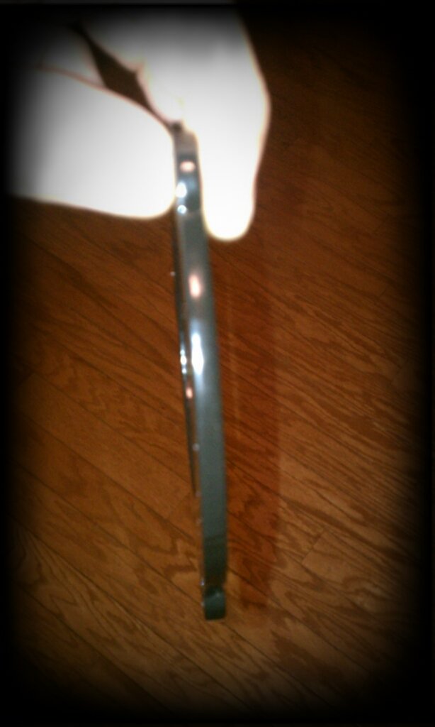

  20. Aug 2, 2012 at 8:15 PM
    #20
    Alby22
    Alby22 Well-Known Member
    Jul 8, 2012
    #82155
    312
    Ashville, Ohio
    Cement 2020 Toyota Tacoma TRD Sport 4x4 Double Cab, Long Bed
    here are pics of the trim packers I received today
    They measure about .200 thick (which is just a little over 3/16's of an inch.)
    I talked to a rep from Rocky mountain Outfitters, and he explained that those are installed on the top of the strut. Both spacers are the same thickness, and he said that they have never had any feedback from customers complaining of a "lean" after installation
