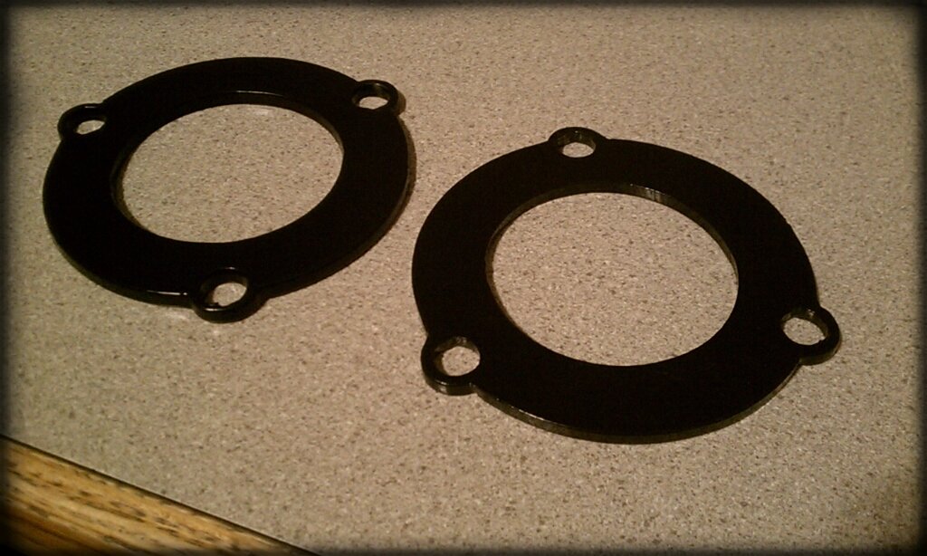

    those are just top plate spacers. They will give an exrta 1/2" of lift..
    The OME trim packer is this...

    I see, but mine go on top, note the holes for the strut bolts. 2710843D_22f267579aac3e4792c2b478a070a49f62e0aaca.jpg
    The rep said it doesn't change the compression of the spring....and he seemed clueless about the left side lean. Also, if the spacer is only .200 thick, how is that supposed to account for .625 of lift???? I know that angles are involved, but that seems like a lot of lift for a .200 spacer. All I want to do, is improve the ride of my truck, and for it to be close to level...what a pain in the a$$ this is becoming....

    those are top plate spacers just insert above top plate.

    The trim packer i showed is to correct the Taco lean that most all tacomas have. So you should install this on the drivers side when installing your OME lift.
    The spacer you got are top plate spacers. 1/4" spacers= 1/2" of lift and so on.. There for giving a bit more lift so that people can get to or close to 3"s of lift.. I have the 1/4" spacers myself.
    The 885's should give a V6 4x4 about 2.5" of lift.. DC and AC models will be slightly different.
    So if you get 2.5" of lift from your 885's and want 3"s of lift, then just install your top plate 1/4" thick spacers and you should be good to go.
    Hope this clears some thing up for you guys..:)

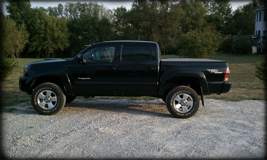

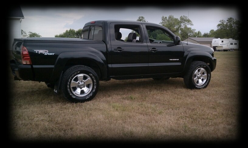

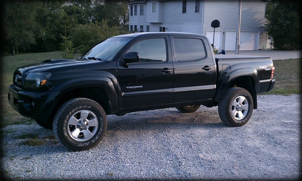

    Well, here it is....I put the OME trim packer on the drivers side, and added my two top plate spacers. tell me what you think,

    Looking good
