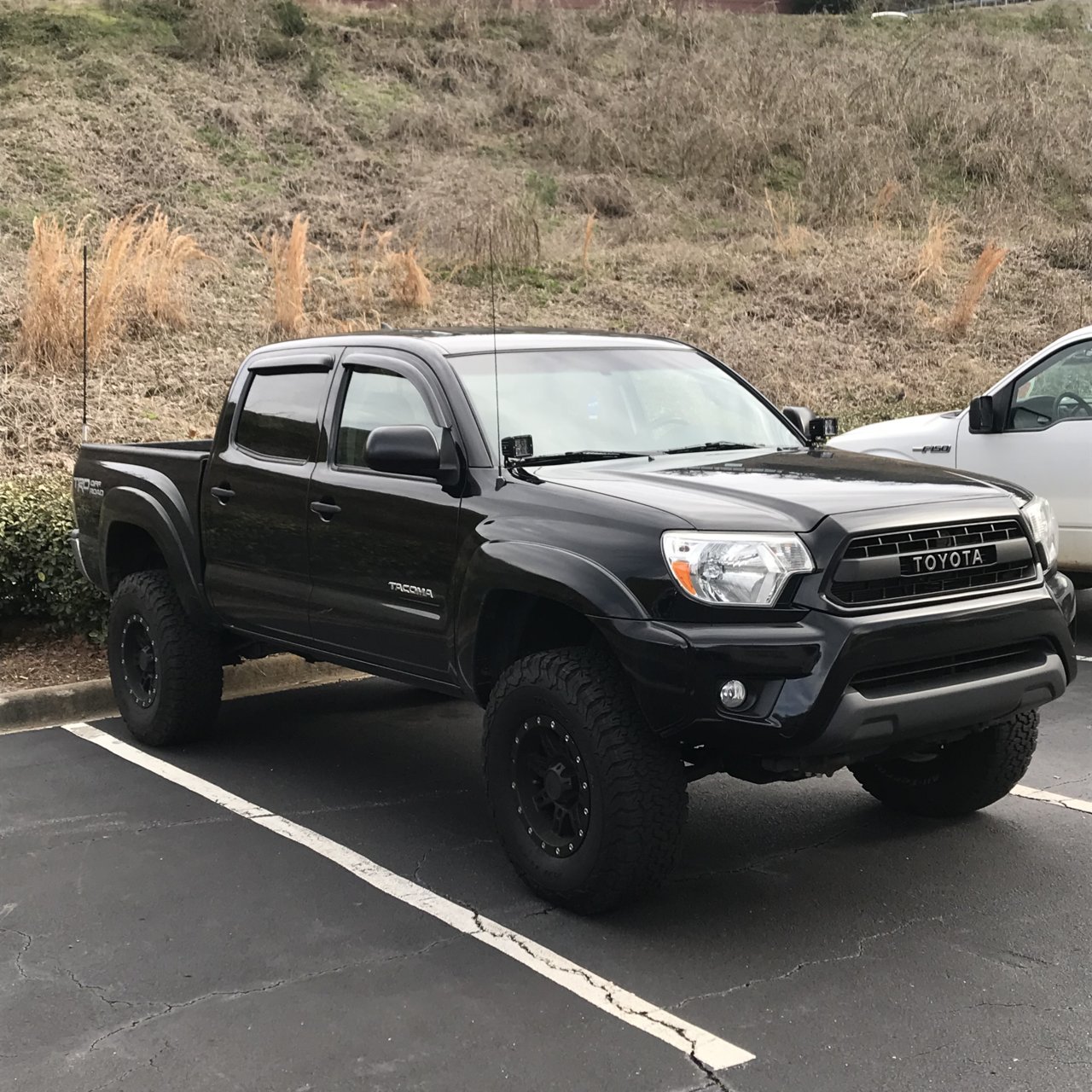

    2014 Tacoma
    dakars and 887s
    Travesty [OP] likes this.

    Just checked out your build thread. Looks like you still have some rake but seems to be the perfect amount. Any idea on measurements?
    JKU3000 likes this.

    Nope, of course I forgot to take any when I put the lift on. I also have the heavy dakars so the medium might not give as much lift.
