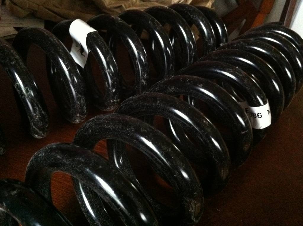

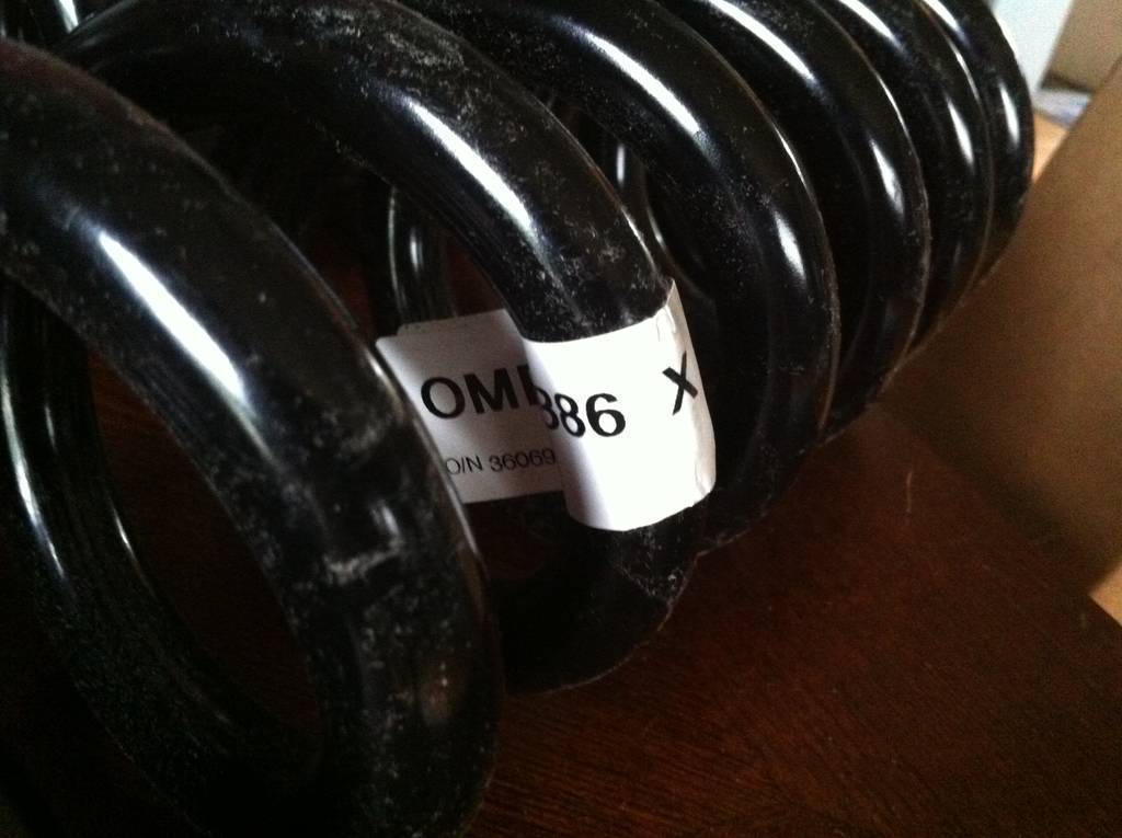

    Just scored some brand new 886's for $45 shipped (yes, hate on). I currently have a 1/4" and a 1/2" toytec spacer in my stash. Will I need the 1/4" on the 886's to compensate for the taco lean? And to anyone insterested I will be selling my Eibachs with ~ 3K miles on them.

    Well they actually arrived :D
