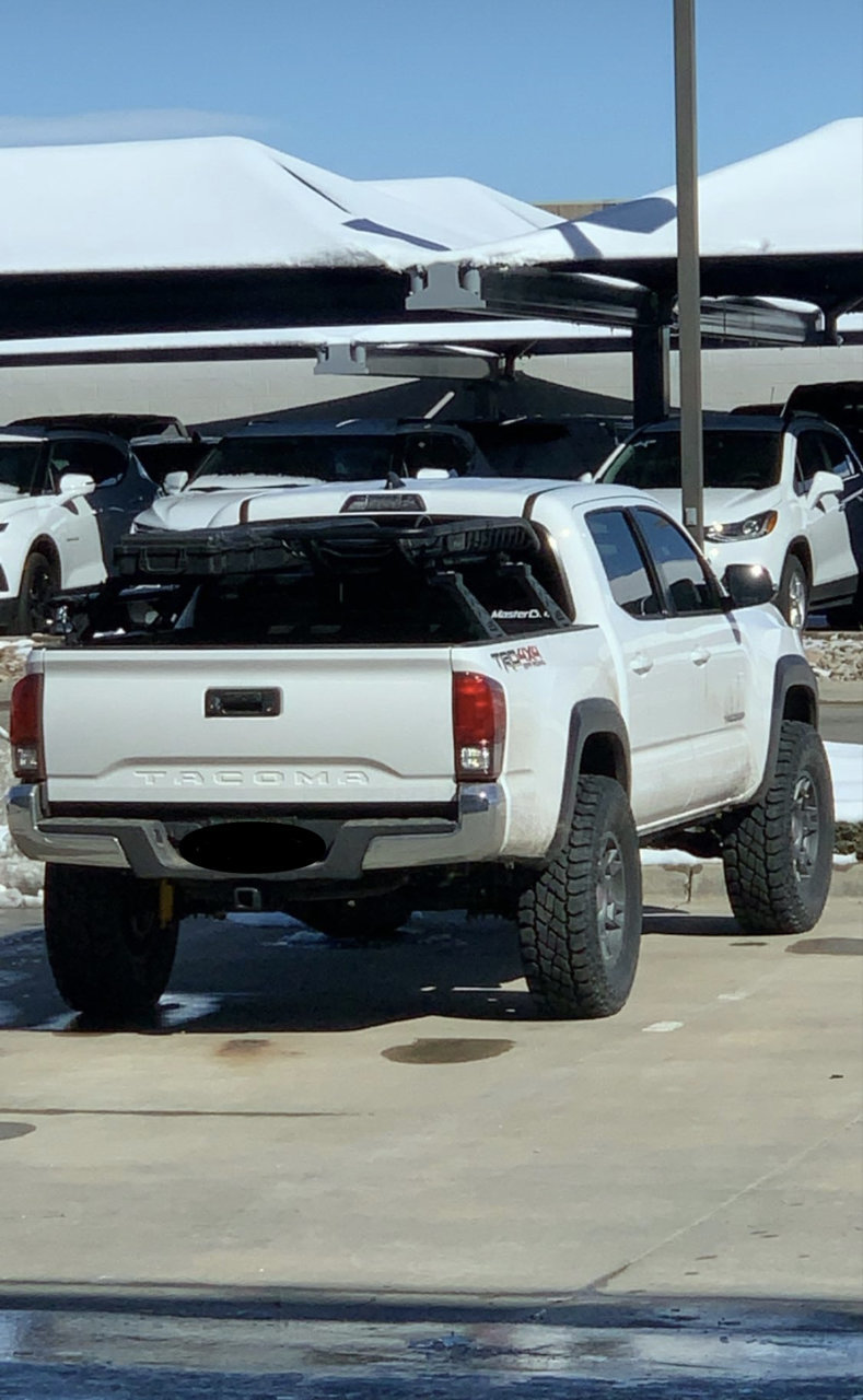

    8DE6875F-69BB-4EDE-9FFB-3944AEBDE7B3.jpg I got 5100s around with 888 in front and single aal in back with overload leaf removed. I still have 1” of rake. This means the 888s did not give me the lift expected. I would probably have more rake if i went with 887.

    Wow! Do you know what your hub to fender measurement is? Definitely doesn’t look like you got a 2.5” lift to me, but pics can be deceiving. Your fender flares could be making it look different to me as well. I keep seeing reports like this and of excessive settling. Really has me scratching my head. Currently researching some other options like the Dobinson & Eibach coils, but my gut still wants to go with 888s as I know sometimes problems get blown out of proportion on forums.

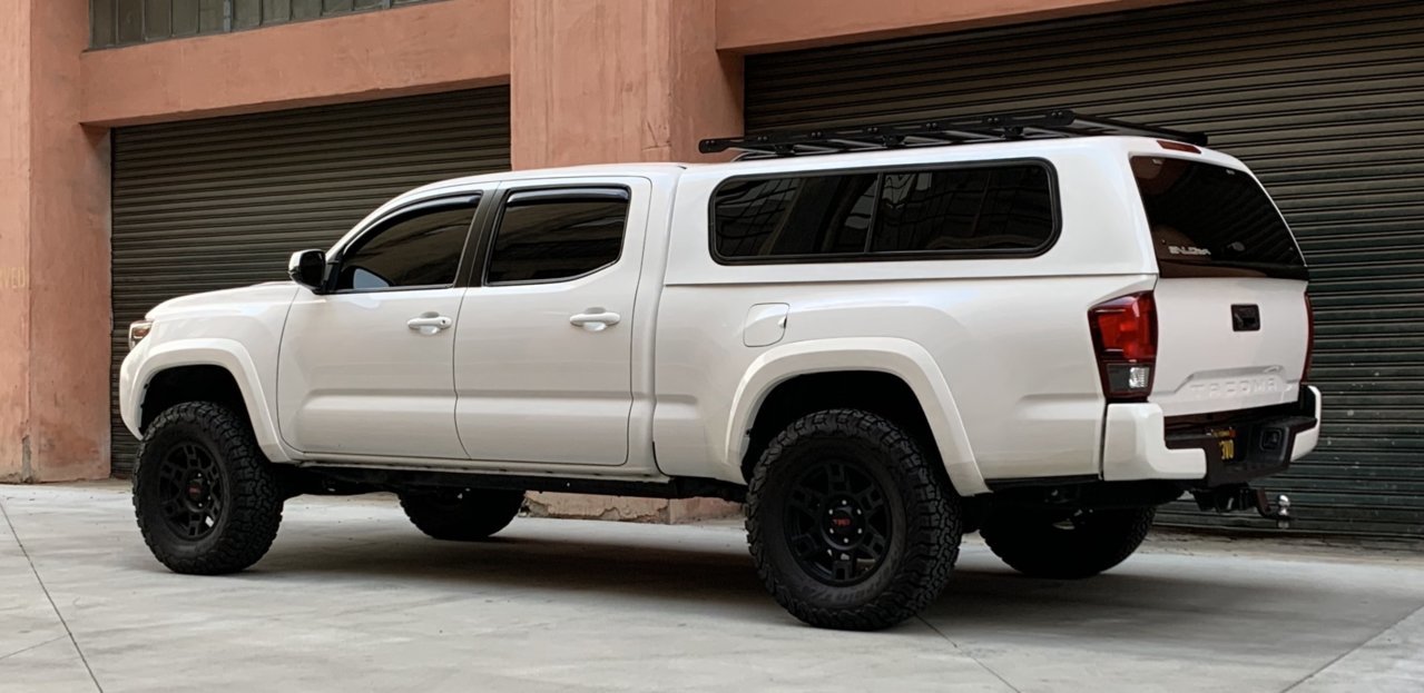

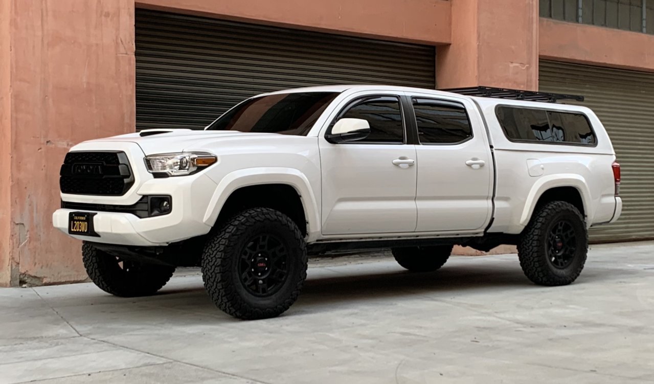

    09CAB75E-C304-454E-9547-EB2B59BDB31E.jpg D243D335-3A66-4BEE-A583-161BBE2BDDEB.jpg

    Truck looks good. How’s it riding? How long have you had your 887s & did you maintain 2” of lift once they broke in a bit?

    Thanks, it ride’s great. Way better than the stock sport suspension. I switched from 885 to 887 to achieve more lift probably 6 months ago, but I drive quite a lot for work. I’ve never actually measured my lift, but haven’t noticed any significant sagging in the front. The back sagged some with the addition of camper shell, roof rack, and constantly transporting a couple hundred pounds of tools.

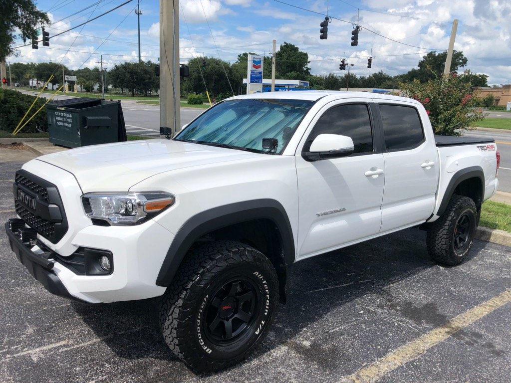

    016CB1F9-BC33-4094-BCE0-3446EDB7AAE6.jpg Here is before after right when it was done. Seems like i was extra low to begin with but my dumbass forgot to take before measurements

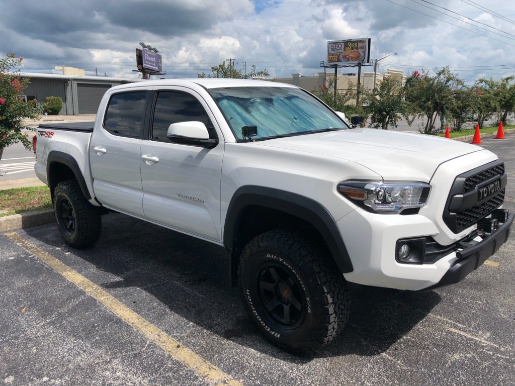

    OME 886/HD Leafs w/nitrochargers LVL8 MK6 16in Wheels w/265/75/16 BFG KO2 Rigid Ditch Lights w/CaliRaised Brackets Various MESOs B&M Trans Cooler WeatherTechs LED Hi/Low w/Fogs Pop N' Lock Tailgate UltraGauge MX HD Front Brakes OVTune 1.05 2000 T4R SOLD 2014 RAV4 SOLD 2008 FJ Cruiser RIP 2010 Scion tc

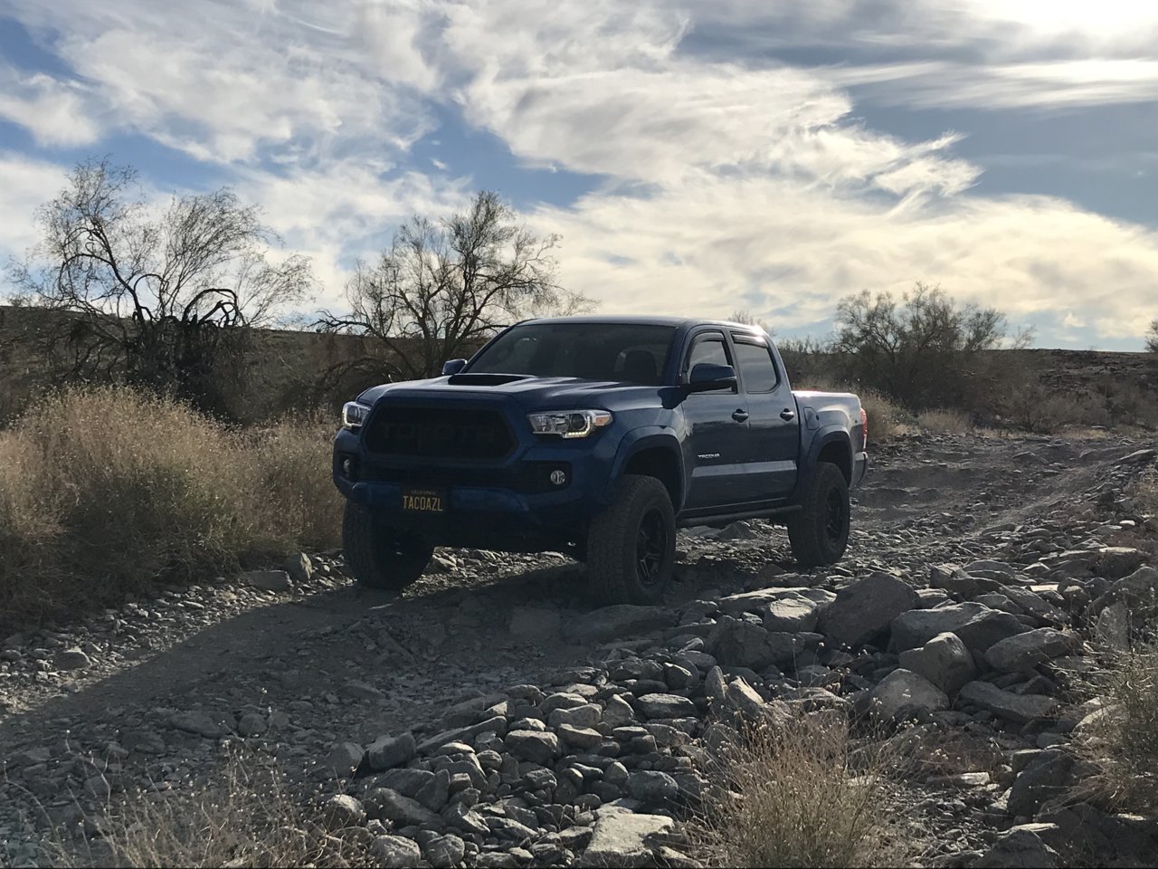

    I have the 888's and the HD OME rear leafs with a camper shell and no weight up front, couldn't be happier with the ride. Also running the E rated KO2s in 265/75/16. This is right after I installed them, before the shell.
    IrishRed[OP] and CaptainBart45 like this.

    Truck looks good & I’m glad to hear that you like the ride. Now that you’ve had the 888s on your truck for a little while, how much height did they give you? Thanks?
