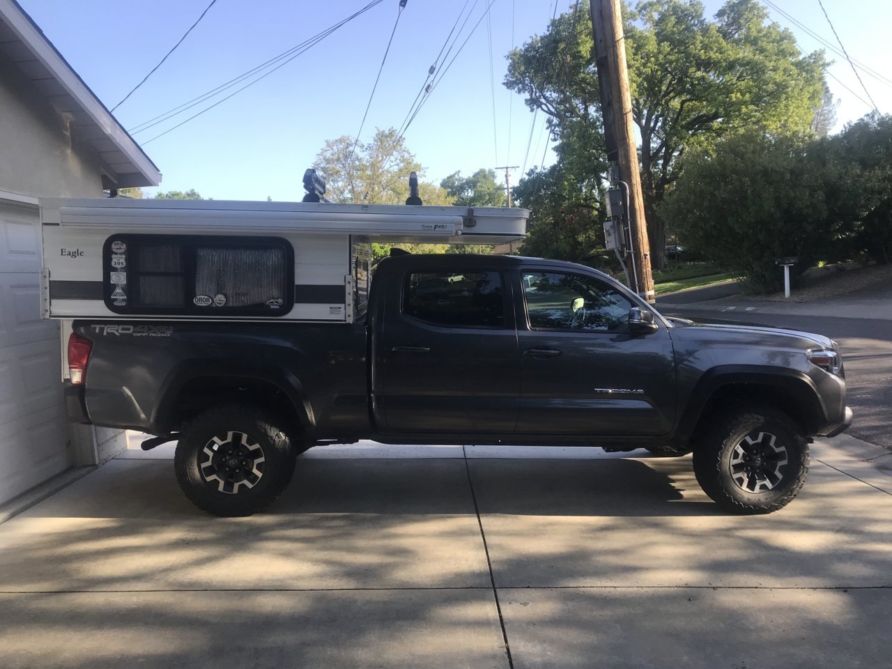

    887s on 5100s with an icon AAL here. Weighted down with sliders, victory blitz, and winch. Still about 2.5” or so if lift. On 265/70 17 tires
    hope this helps

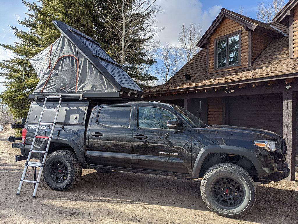

    OME BP-51s and 96 leafs. 285/70 R17 BFG ATs. Alu-Cab Explorer Canopy & Expedition Tent.
    I just had to pull up my parts invoice to remember exactly what I ended up going with.
    2 - 2888 Front Coil
    2 - Old Man Emu 10mm Trim Packer
    2 - 90021 Nitrocharger Sport Strut Front
    1 - OME95PF5 Driver Front Strut Trim Spacer
    2 - EL096R Rear Leaf Springs
    2 - 60091 Nitrocharger Sport Shock Rear
    2 - SB108 Spring Bushing Kit Rear
    1 - FK29 Driveline Fit Kit
    4 - U53A U-Bolt and Nuts
    I researched a bit and went with this combo to future proof from sagging, even after I end up adding more weight to the front. I just went out and measured to be sure and have 23.5" hub to fender all the way around. The rear is probably as heavy as it'll ever be with 300lbs of canopy & tent, bike rack + hitch swing, and the bed is packed with camping gear including water. Much more weight than this and it starts to squat a little in the rear. With the tent off and the bed empty, I probably gain a 1/2"-3/4" in the rear. If anything, with the 10mm spacers and no additional weight, the front is a little too high. But, it should be about perfect with a low profile bumper and winch w/synth line. This is after a year and a half so it's not going to settle any more than it has. Although, I think those measurements are about what I had not long after installing.
