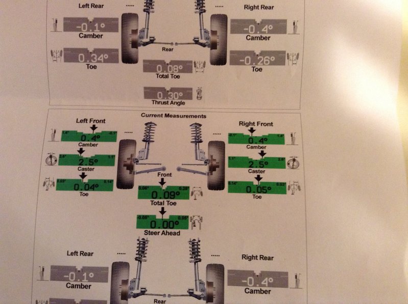

    What did you get for alignment specs with the Camburgs? As because of me they changed their website to state that they are meant for lifts up to 2.5 inches and not 3 inches. If you can post your specs from the alignment

    I dropped it off this morning and requested 2.5 degrees caster. I'll update this evening when I pick it up. I will say it drove well to the alignment shop at 75mph.

    I was only able to 2.0 to 2.2 Caster with 0.0 Camber which is garbage for 600.00 arms. Should have gotten LR UCA's where people are getting to almost 3.0 Caster. The alignment guy got me to 2.5 to 2.7 Caster with having positive Camber at almost 0.5. So my Camburgs are already sold and am waiting for a nice set of JBA High Caster arms for 425.00. Like I said this is why Camburg has now changed their website to state that these are for 1" to 3" of lift (2.5 recommended). Good luck maybe you will get better alignment specs. But please get the after alignment spec sheet to post on here

    Just like you said, lots of camber but it drives like a dream. I may have things redone when I get the new tires mounted but for now it really is nice on the highway.

    Not bad but, but definitely makes the Camburg's not worth 600.00. Like I said mine are sold and I'm going with these for 450.00.
