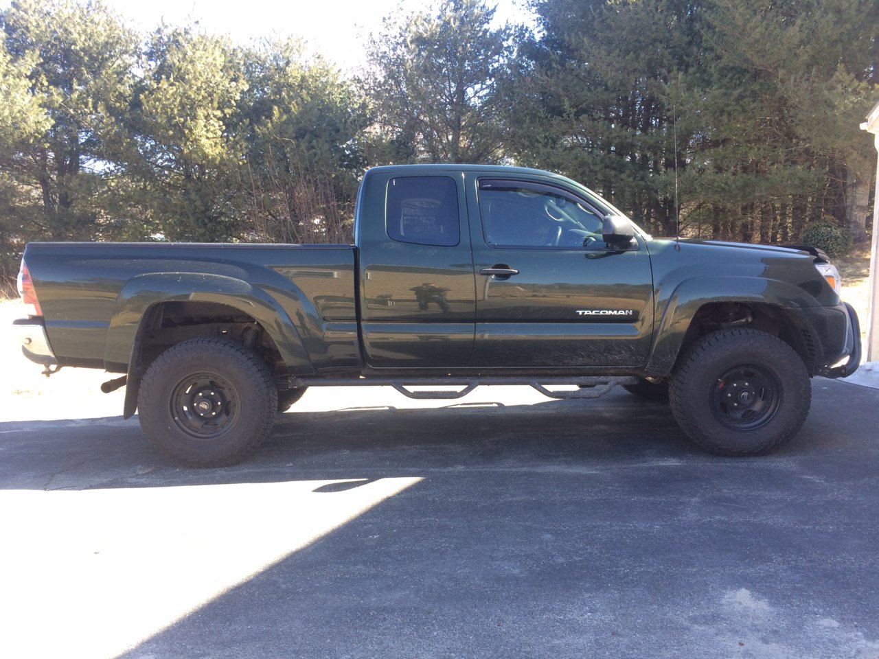

    3" lift front Bilstien 5100s at 0 with OME 887 coils, Freedom Offroad UCAs, Bilstien 5100 rear shocks, 1.5" lift rear Wheeler's Offroad progressive AAL packs, Airlift helper airbags, N-Fab nerf bars/side steps, all sittin' on Falken 265/75/16s on American Racing 16s
    So I am looking at replacing my 5100s up front with OME nitros 90021 but I noticed everything says for 1-2” lift or 25mm lift which is about 1”
    I have OME 887s which provide about 3” of lift. I’m a assuming 90021s will work just fine with 887s?

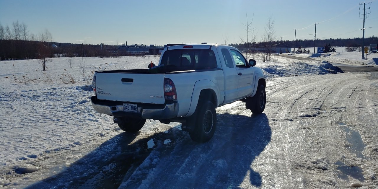

    Hey guys, just got the lift done, front bilstein 5100 with OME 2887, back 1.5 AAL with bilstein 5100, also changed out the ECGS bushing mine was worn out. Love the look and the ride is amazing better then stock. No vibrations drives smoothly.
