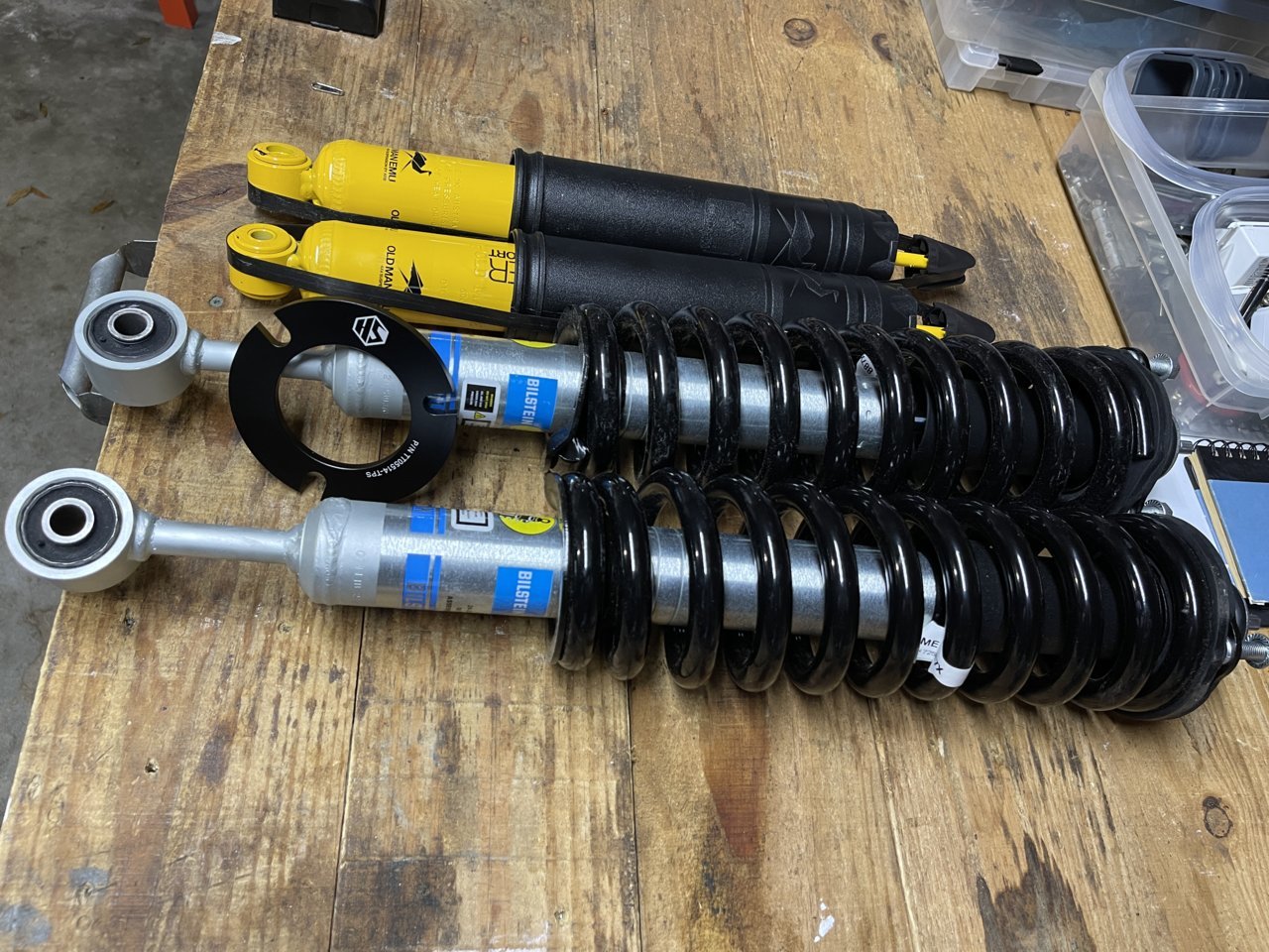

    Posted this in the "what did you do to your second gen today" but figured this thread might have more direct experience. I got my lift finished and everything bolted back up. Goes in for alignment Friday DCLB 4x4, 887/5100 with Icon RXT Option 2/B110. Measurements with full tank of gas.
    Stock - Lifted
    DF 19 3/4" - 23 1/4"
    DR 21 1/4" - 25"
    PF 20" - 24"
    PR 21 1/2" - 25 1/4"
    Now I am planning on adding a skid set and am anticipating the front settling down closer to 3" lift. However with a 1/4" spacer on the driver side for taco lean I am still 3/4" lower than the passenger side. Should I switch out the spacer plate for a 1/2" plate or a 3/4" plate to get it even with the passenger side?

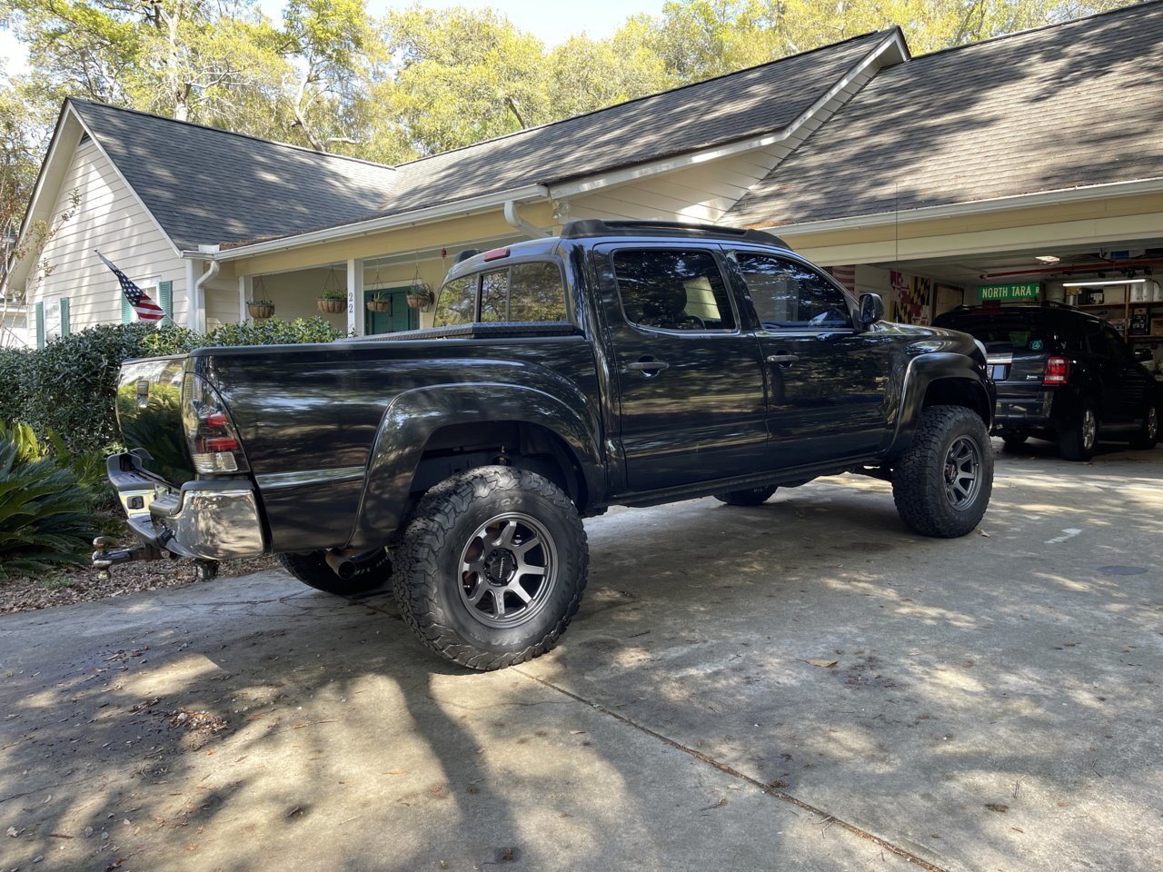

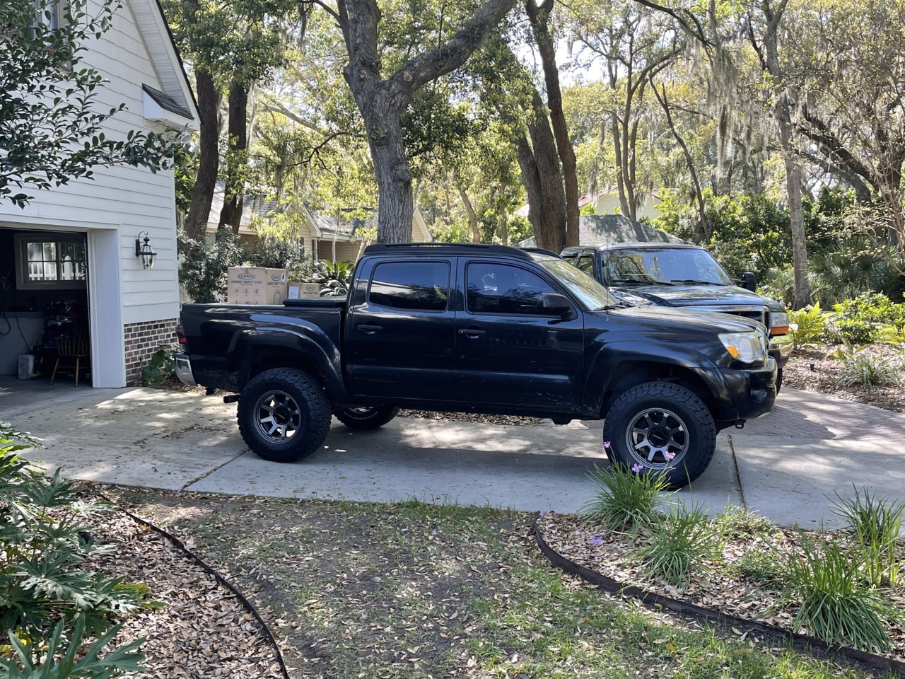

    Installed this combo. Surprised it has popularity
    F: 887, 5100 @ 0
    R: Wheeler's AAL + 1" block, 5100
    dealing with:
    -clunking
    -harsh ride
    -positive camber
    thinking of going 6112/5160 or Icon/Fox/etc
