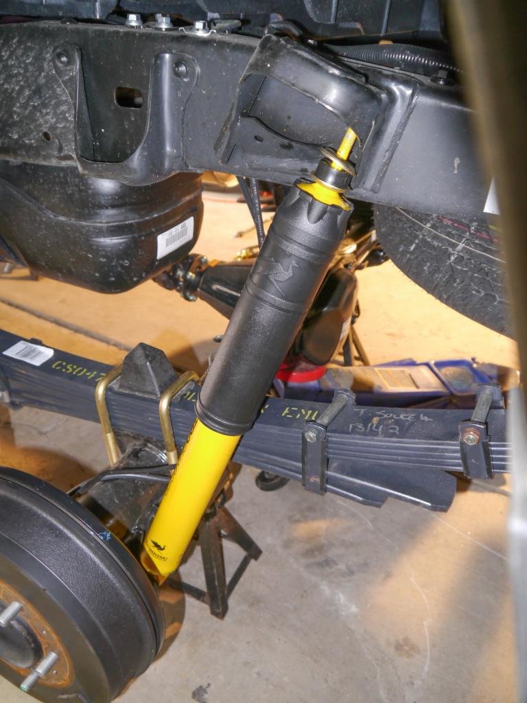

    Also that link you provided you are comparing front shocks collapsed lenghts on the fox's to rears on the OME.
    again, going by other numbers is not the way to go about this..... measure the lenghts you need on YOUR truck. i can GUARANTEE you that if i were to put those fox shocks on my truck the shocks would bottom before hitting bump stops because i have actually MEASURED in the real world on my truck the lengths i need.
    Same goes for the front. Pull the shock out, and cycle the suspension by hand and take measurements.
    FYI, the stock UCA will hit the coils at full droop and the upper ball joint is the next limiting factor shortly after.
    the FRONT OME 90000/900021 have an extended / collapsed length of 543 413 respectively.
    FRONT 5100's are 573 / 432.5 (that collapsed length is nearly the same as stock and 10mm longer extended than stock)
    So if you were to get yourself spaced down with a 20mm spacer on the OME shock to get yourself at stock collapsed length... you still get less droop than a 5100.

    Louisiana
    2010 DBL Cab TRD OR 4x4
    Just a few
    Why are you doing a suspension lift as well as a spacer lift up front?
  3. Aug 24, 2015 at 9:13 AM
    #23
    urban
    urban [OP] Well-Known Member
    Feb 21, 2013
    #98124
    438
    Illinois/Michigan
    12 DCLB sport OME lift
    305/65r17's on 17x9.5 Rotiforms Cab mount chop 4.10 gears Detroit true track OME 885's Dakars Camburg UCA's Undercover SE Weathertech liners and visors Black headlight mod Debadged Rock Blokz mudflapps (oversized)
    using the spacer (32mm) in conjunction with the 883 coil (-20mm) to gain about 12mm lift & uptravel at the coil and 20mm down travel at the coil

    the coil length has NOTHING to do with extended and collapsed lengths of the shock.
    Using the OME front shock with a 32mm spacer nets a collapsed length of the shock thats 10mm LONGER than stock which MIGHT be ok... but you would have to cycle the suspension to make sure and account for bump stop compression.

    you never made any designation on front or rear sir. FYI fox may or may not measure their shock the same way... they might be measuring all the way to the top hat... so you cant compare apples to oranges.
    Keep your ducks in order. Either way.... cycle the suspension, measure for yourself.... everything is different... im done with this thread and the attitude.

    How would you possibly end up with less unless you over limit it? I could understand if you said potential not any more.
    looks like more than half an inch to me?
    Was gonna link to a another thread on TW with a guy suggesting that his OME rear shocks where limiting him about 4". It had pictures of the truck being flexed with the shock unbolted but I can't seem to find it.
    Wouldn't a u bolt flip make the bump stop further from the stop opposed to the stock mount offered with the superbumps they offer without the u bolt flip?
    Obviously coilovers are better. they also cost 2x as much.
