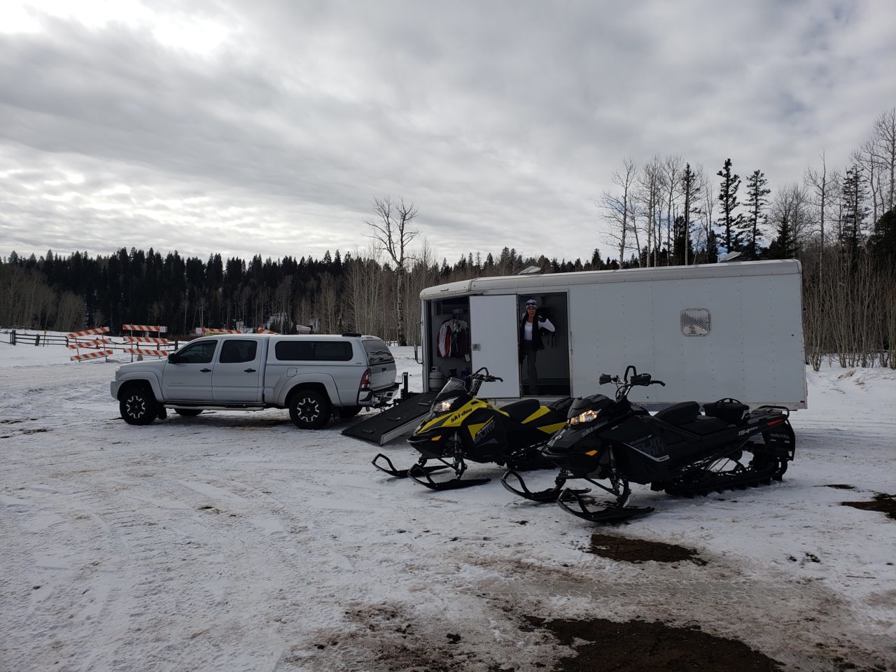

    That's why I went with ome too, & I will say they perform well I just hate the noise. I've got a pretty decent sound system in my truck but I don't like it on party mode all the time! This is only pic I could find of my sled trailer in tow of the tacoma, but it was the day after I bought my truck, still stock

    Pretty similar trailer, mine definitely gets loaded for work...getting close to that max towing capacity...
